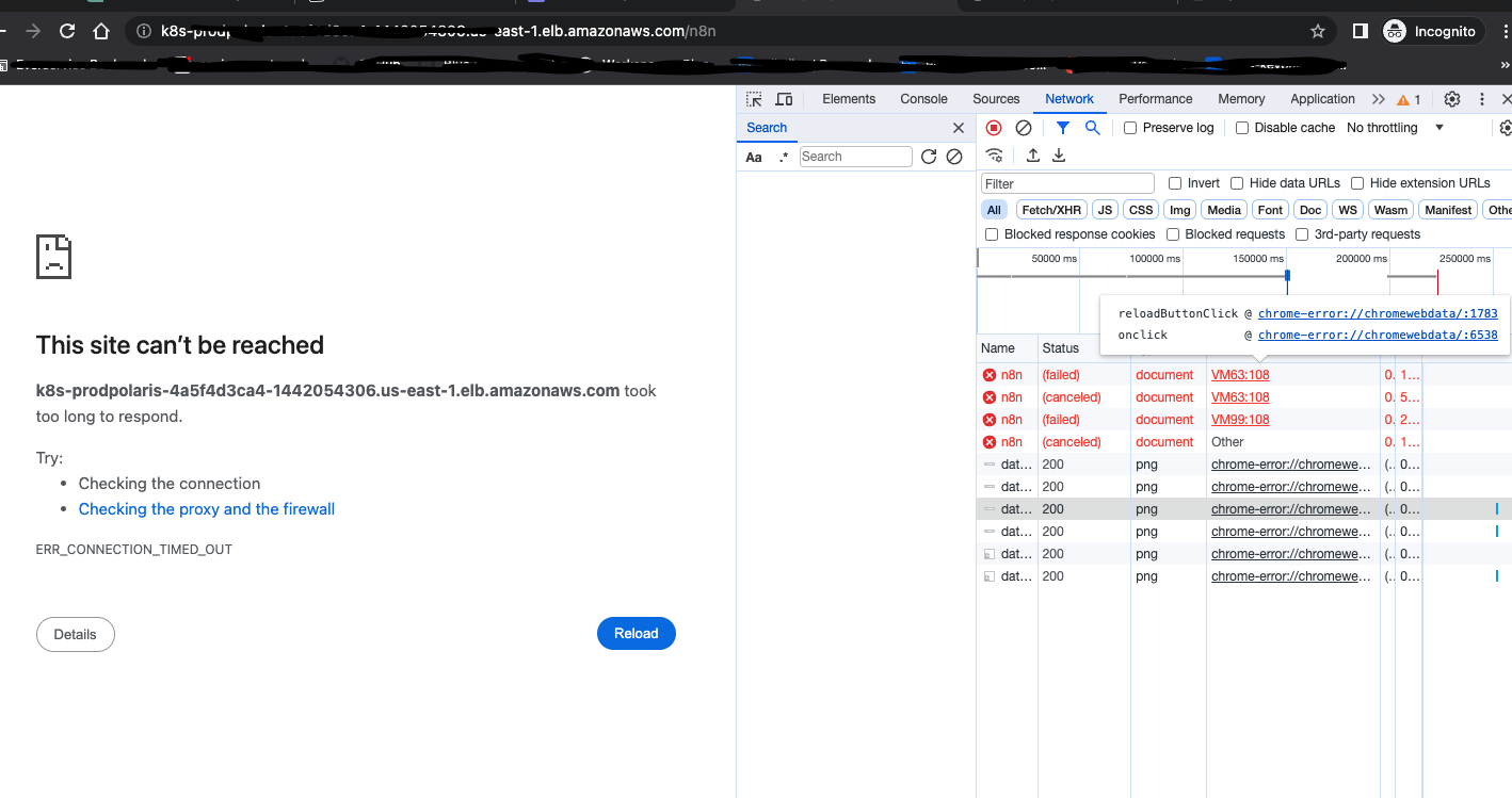

so, i deployed n8n under ALB where other backend services are running and this is what i get when trying to access n8n with alb address. when using domain URL exampe.com/n8n it redirects me to my website right away.

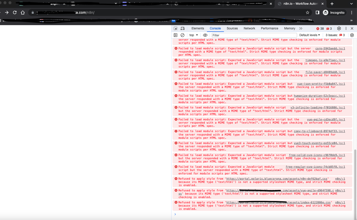

these are the errors form console inspect. please note i can see n8n.io- Workflow Automation in the browser.
some of the errors:
Refused to apply style from ‘https://xxxxx.com/assets/index-6122886e.css’ because its MIME type (‘text/html’) is not a supported stylesheet MIME type, and strict MIME checking is enabled.
index-8ab146da.js:1
Failed to load module script: Expected a JavaScript module script but the server responded with a MIME type of “text/html”. Strict MIME type checking is enforced for module scripts per HTML spec.
If you browse direct does that work? I would be tempted to try a simplified deployment first and see if that works then grow it out as needed.
So I’m as well having same issue, so when I am using just domain it is working but it is not working with path. So When I use domain as example.com it does work, but when I use example.com/n8n it does not work so how can I implement that example.com/n8n in that case there is Failed to load module script: Expected a JavaScript module script but the server responded with a MIME type of “text/html”. Strict MIME type checking is enforced for module scripts per HTML spec. this error
