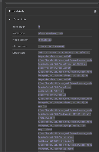

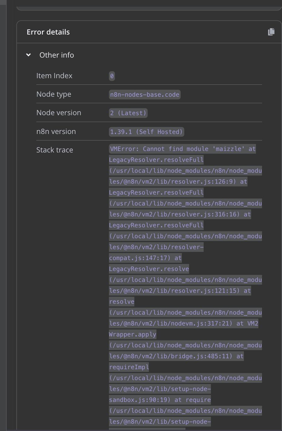

However, trying to get the package to work using const Maizzle = require("maizzle"); (or @maizzle/framework) results in an error that the package has not been found by n8n.
Still haven’t been able to get this working myself sadly
Hey @victorb,
What is the full error you are seeing? Are you also actually using your custom image and not docker.n8n.io/n8nio/n8n in your compose file?
Yes, I’m using my custom image.
The full error is:
