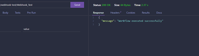

Workflow is inactive, I’m using thunder client for the request and getting the response
{ "headers": { "host": "localhost:5678", "connection": "close", "content-length": "0", "accept-encoding": "gzip, deflate, br", "accept": "*/*", "user-agent": "Thunder Client (https://www.thunderclient.com)" }, "params": {}, "query": {}, "body": {}, "webhookUrl": "https://domain/webhook-test/Webhook_Test", "executionMode": "test" }
