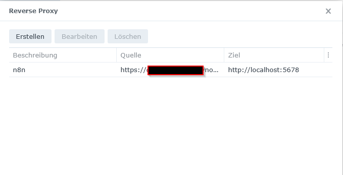

Meanwhile I played around and found something regarding reverse proxy on the Synology. I set up Synology to forward “external-hostname:port” to “localhost:5678” and the router to forward from external to synology:5678 and somehow I reach the webinterface. But that doesnt seem to be end of story, because:

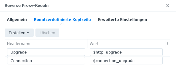

Yes, true. I forgot to configure the cookie handling. This is the settings in Synology for reference. Sorry they are in german, but I can translate if needed :slight_smile:
New status is my issue is solved due to increased knowledge :slight_smile:
