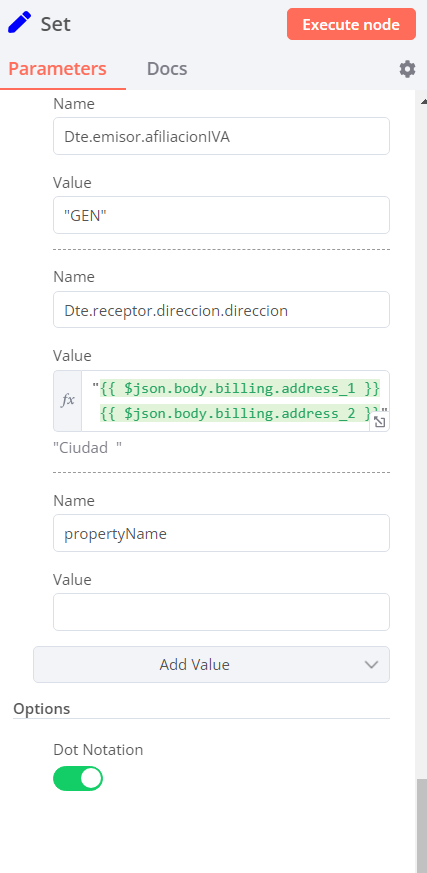

I’m migrating from Integromat to n8n but I’m struggling to find something similar to a JSON module inside n8n, currently on integromat there is a module to create JSON visually that let you map fields in order to create a collection, so it can be sent via HTTP Request, is there something similar to this on n8n? or I need to create the JSON manually through code? Thanks in advance

Yes there is sadly currently no dedicated node for it and would rather have to be done with a Code-Node. You could also use a Set-Node but that really only works well when the data is flat and is less fun with deeply nested data as you can see in the following examples:
Thanks @jan I was able to workaround until now with the Set node and the dot notation option to build a nested JSON, I’ll keep trying with this if I can do what I looking for, BTW if not I know I need to go for the node code way. Thanks again
