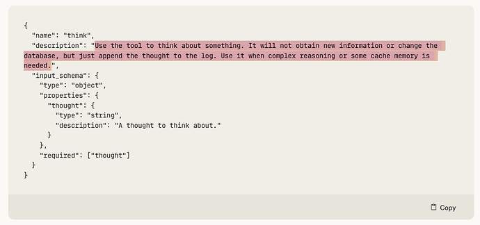

I think the description you provide in the Think Tool can definitely change how the AI agent interacts with it,
The default Think Tool Description in n8n is coming from the Anthropic article:
I’d reccomend read it to know more about it..

According to the Anthropic article @mohamed3nan linked, the Think Tool description can influence thinking, BUT is not as effective as including instructions in the System Prompt.
We found that, when they were long and/or complex, including instructions about the “think” tool in the system prompt was more effective than placing them in the tool description itself. This approach provides broader context and helps the model better integrate the thinking process into its overall behavior.
The Antrhopic Article buries the lead on the tool description, which was @leonardorick’s difficulty as well.
I believe that the description has a more powerful effect on if the AI should use the tool. I’m speculating here. Again, not well documented and I’m still new.
I also found the following in the Anthropic article which further encourages putting instructions for thinking into the System Prompt.
