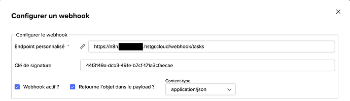

Here is some screens.
Webhook configuration in the CRM Sellsy

My Hostinger VPS was initially using the default subdomain: https://n8n.srv1234.hstgr.cloud (no custom domain configured).
After some investigation, I discovered that certain DNS providers have blacklisted the hstgr.cloud domain. This could explain why, depending on the DNS configuration of a service provider like CRM, the DNS resolution for my webhook URL sometimes failed—resulting in missed webhook calls.
To resolve this, I linked a custom domain name to my VPS and updated my Traefik configuration accordingly. Since making these changes, the webhooks are working reliably and I haven’t experienced any further webhook losses.
