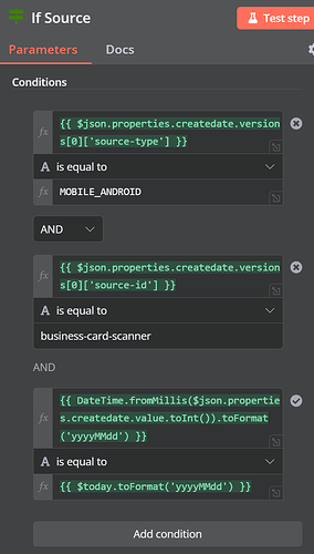

So better having eg
{{ DateTime.fromMillis($json.properties.createdate.value.toInt()).toFormat(‘yyyyMMdd’) }}
in Multiple fields in a set
vs a clean code and a variable and then using the result in several times?
I did this in a code block because I thought it would be easier to read but I guess in theory I could throw it in an if block right at the start
Then no code block at all
