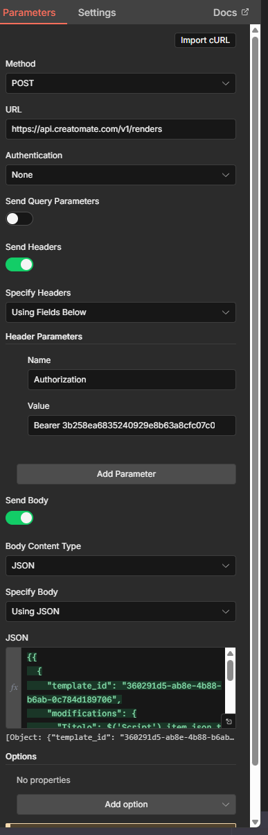

  • Hello! Please could help me to understand why give me this error? i give the same Authentication for creatomate render and download vide (scarica video)…. please my brain is done and i dont’ found a solution for this. tell me if i need to change node after permission drive or i need to change something

Looking at this screenshot, it seems you’re using the same credentials for Creatomate but with a different link,
I suggest trying two things:
1- Use that direct link without authentication or:
2- Since I’ve worked with credentials before, the link would look like this:
https://api.creatomate.com/v1/renders/{{ $('Creatomate Init').item.json.id}}

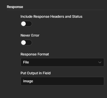

You probably also need to set up the response like this:
give me this error…. i put https://api.creatomate.com/v1/renders this is creatomate render and another in download video. is right? thanks i create a responde file-image but nothing give me this error

Can you just run your workflow that gave you the error you mentioned here:
but remove the authentication and add the response format..

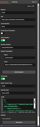

if you want, you can attach your workflow or the last few nodes, that would help.
how i can attach my workflow?
first is node “Creator Render” - Node Wait - Node Scarica Video
Thanks, try this please:
