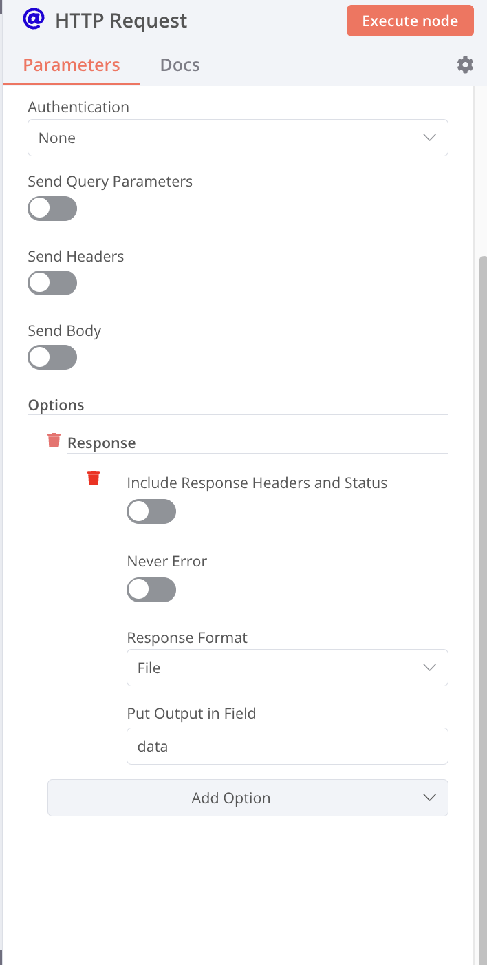

Hi @Philip_Wiggins, thanks for writing in about this!
It looks like you’re trying to get a PDF, which would need an additional setting. In your HTTP request node, can you select Add Option > Response and then set the Response Format to File? Those options are here:
That should let you retrieve that binary data properly! :+1:
