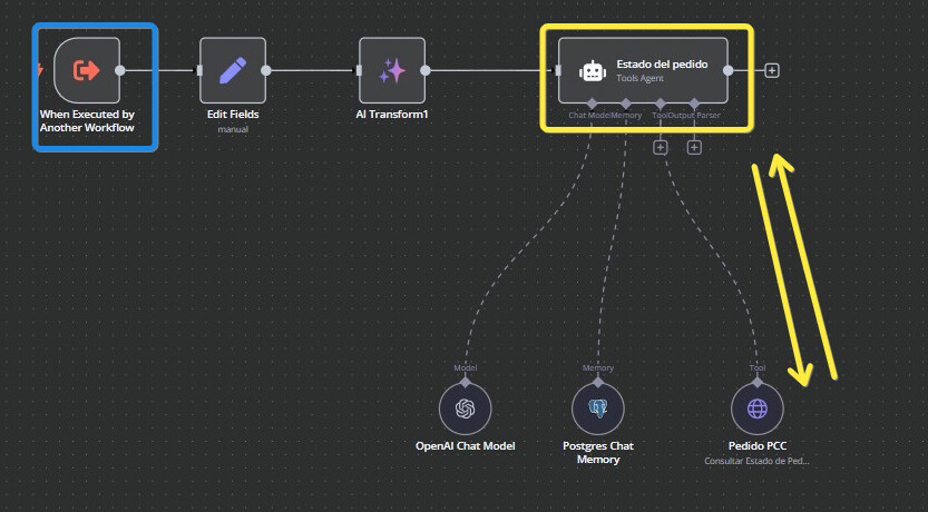

We are having a problem of duplicity of outputs, when from a workflow with an AI Agent (tool agent), we make a request to other tools, which also incorporate another AI Agent.
From the main workflow, we see that we get 2 outputs in the Postgres Memory node, what seems to be the output of the tool (which is correct), and another output that seems to reinterpret the main AI Agent, which is usually a wrong answer.
We have tried passing the output of the tool to the main workflow in a thousand ways, but we can’t find a way to retrieve that information or to omit the AI Agent from reinterpreting the response.
Any help, please?
No apparent errors, just the duplication of answers and the difference between them.
Main workflow:
Tool sub-workflow:
Are you using the same session_id for those chat memories?
In your sub-workflow, try removing the memory node. Tools calls don’t need to be stored in the memory of the chat. Leave it only connected to the main agent.
In most cases the tools should give information to the main AI agent, but shouldn’t be stored as part of the conversation. That can be confusing.
