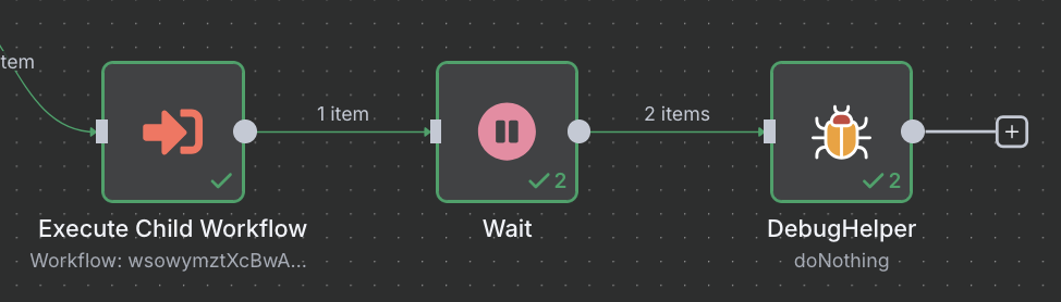

After executing a Subworkflow, and the child workflow calls a webhook to resume the parent, the parent flow duplicates the incoming items, causing the rest of the flow to be executed twice.
NOTE: I’m using a pattern described elsewhere in these forums to Execute a Sub Workflow, and then have the sub workflow call a webhook URL to resume the parent. This is a workaround for the quirky behavior of the Execute Workflow node, where it doesn’t always wait, or doesn’t return the output from the final node. “Wait for Sub-Workflow Completion” is set to False.
I’ve simplified the two workflows as much as possible, so it’s now very small. I have a ParentWorkflow and a ChildWorkflow, specified below.
N.B. (THIS SEEMS TO BE IMPORTANT): The problem only occurs when the child has a “Wait on Webhook Call” node. If I swap this for a “Wait on time interval”, then everything works as expected. I can use the curl below to resume the webhook of the child. Note the EID variable is the execution ID of the Child, not the parent.

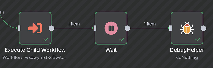

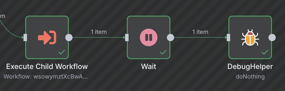

Hey @Marc_Skipp , that seems to be a visualization problem. When I test your scenario, indeed the canvas of the currently completed execution shows the Wait node has 2 outputs. However, when switching to History tab it shows only one (as expected).
Real time monitoring
History tab execution (of the same execution)
As a workaround you can add Remove Duplicates node after Wait node in parent workflow.

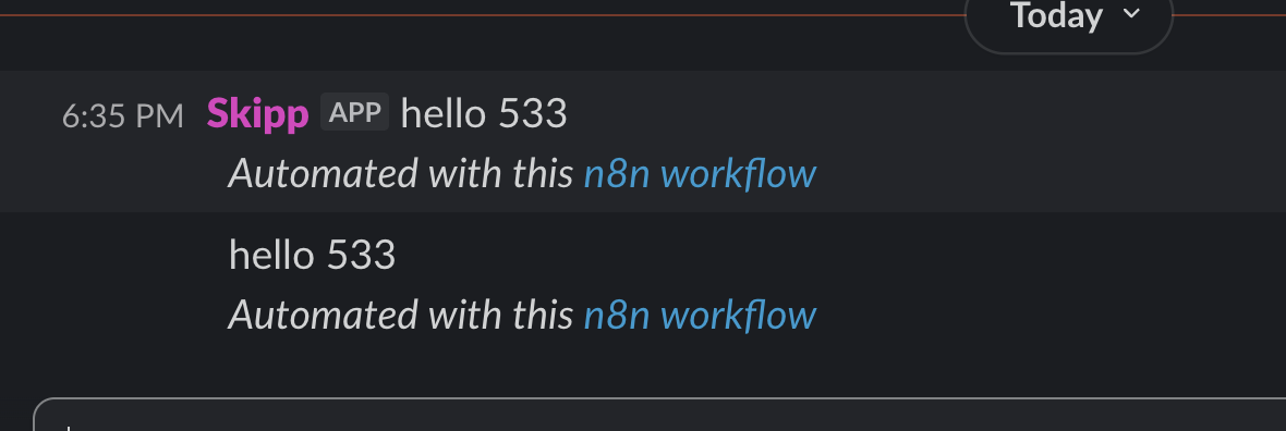

Thanks for the tip. But, I don’t think that is correct. Subsequent nodes are executed multiple times. For example, if I add a Slack node, after the Parent’s wait, I get two messages in Slack (as shown in attached screenshot).

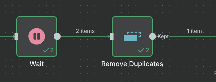

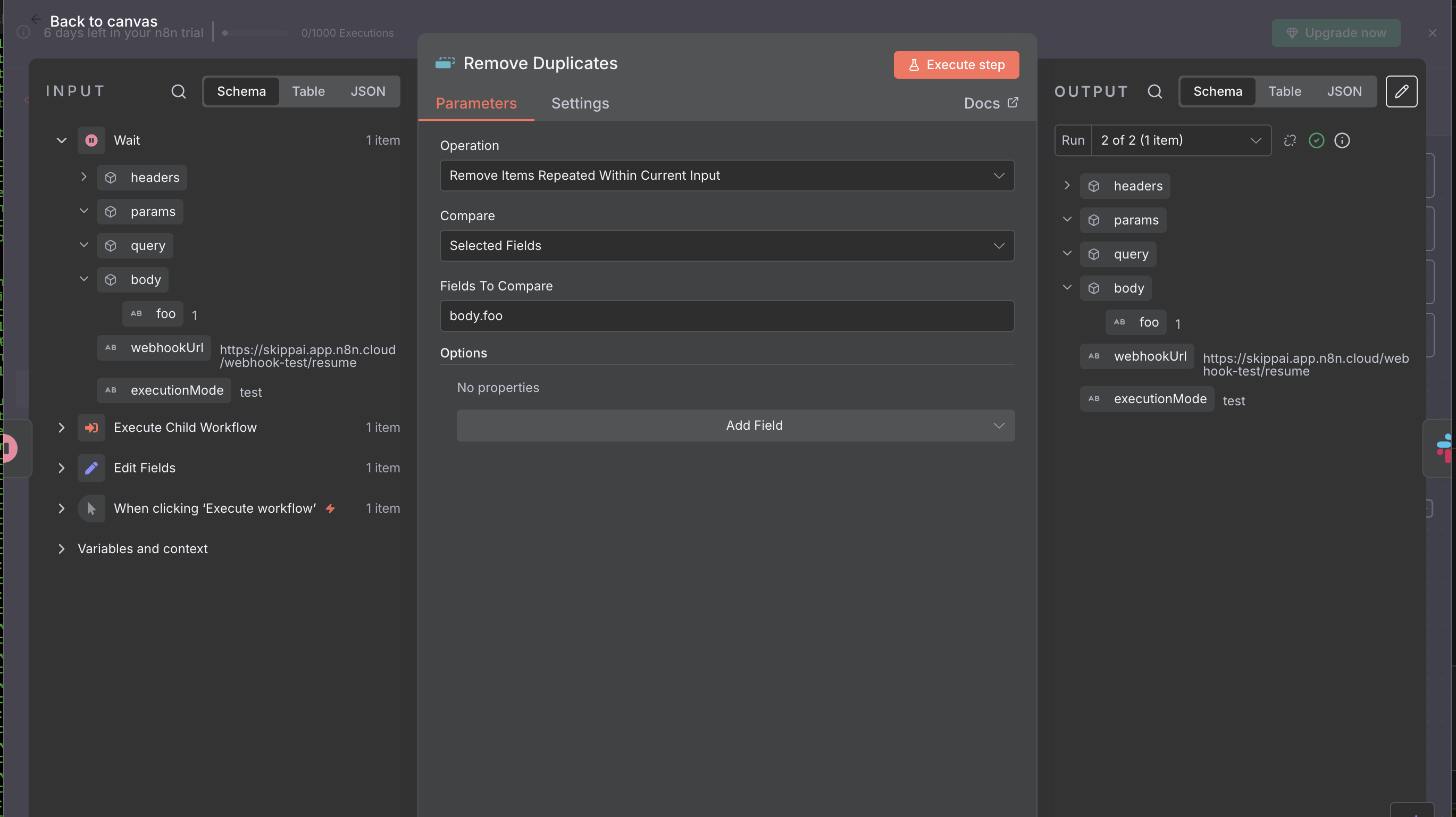

Thanks for this idea with the Remove Duplicates. Unfortunately, no luck with that, either.
This screenshot below shows the result, 2 items coming out of Wait, and still 2 items out of Remove Duplicates. And, indeed, I get two messages in Slack showing the same value of body.foo.
This screenshot after that shows my Remove Duplicates config from the recent execution, with input/output. I’m comparing 1 field, body.foo. Interestingly, from this view, the UI shows only 1 input item and 2 output items as if this were the node that created the duplication. I know from testing, though, that the duplication comes from the Wait, but it seems to me like the Remove Duplicate node is not seeing all the data at once.

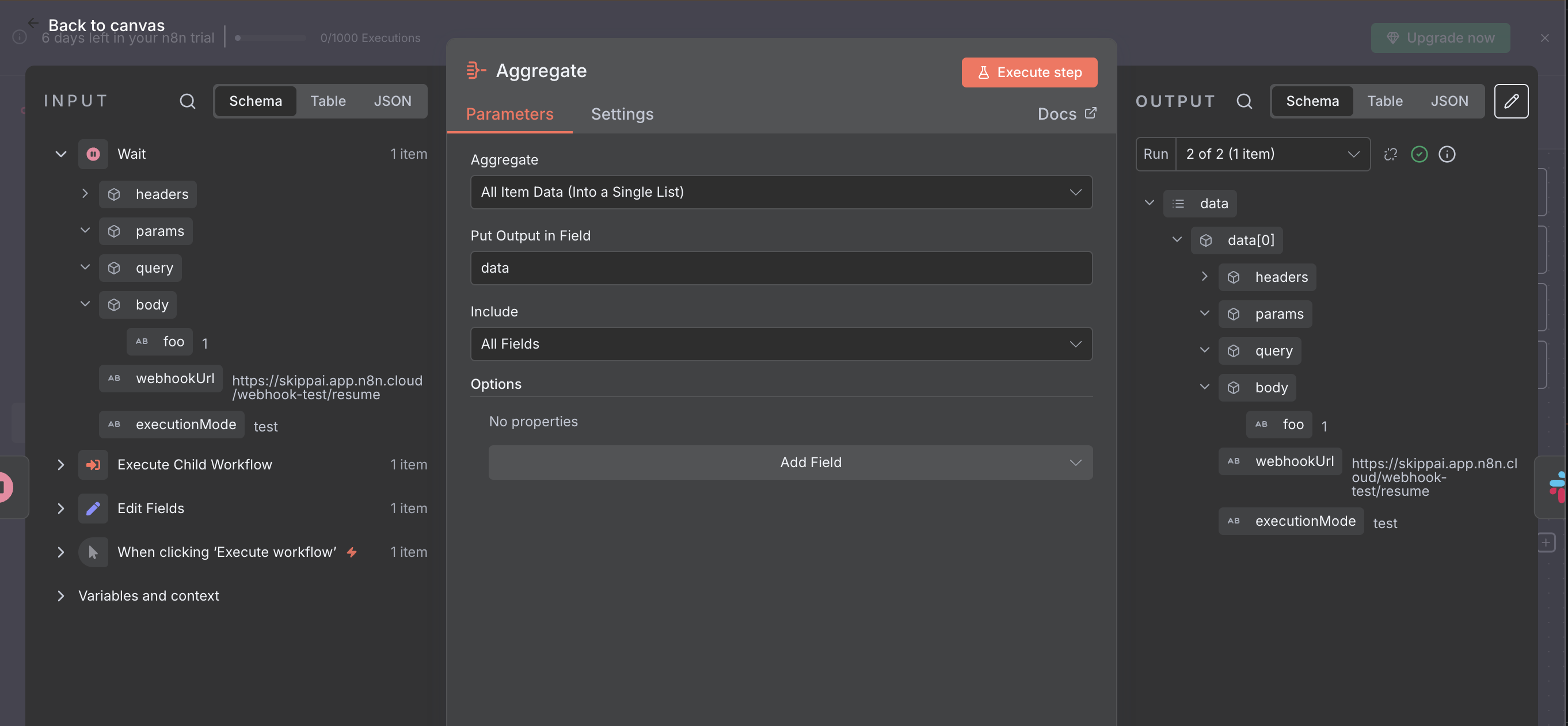

I’m going to playing around with an “Aggregation” node. I’ve never tried that node before, but seems to me there might be a workaround, there. OTOH, I suspect, I will see the same behavior as Remove Duplicates.
NEW PARENT WORKFLOW
AFAICT, the Aggregation node had the same behavior as Remove Duplicates.
  1. The test workflow view shows 2 items out of Wait, and 2 items out of Aggregate continuing to the Slack node.
  2. Expanding the Aggregate node (like Remove Dupes) inaccurately shows only 1 input item, and then 2 output items.
  3. Using the “Run” toggle in the upper right, I can see that the data in both outputs is identical (just like Remove Dupes).

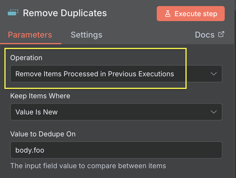

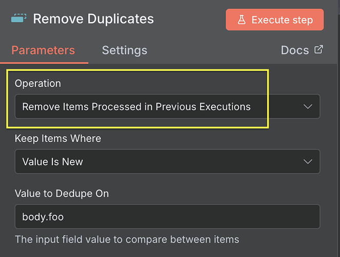

@Marc_Skipp , you haven’t configured dedupe node correctly. You need to pick the “previous execution“ option as those output items are run is separate executions, they are not part of the same item.
@ihortom Confirmed: after following your suggestion, that workaround does work for my sample flows.
