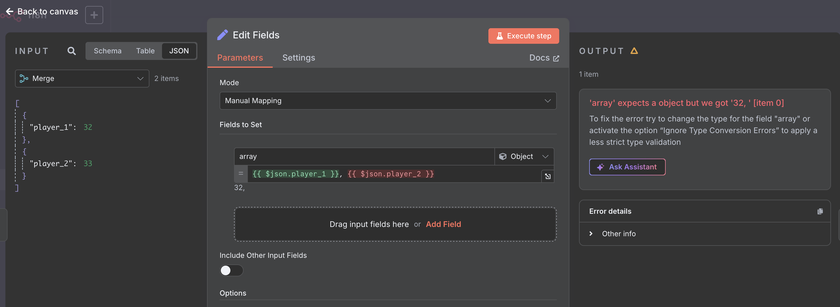

I am using the edit field node and I don’t know what I am doing wrong. The second value just doesn’t appear:
I tried all sort of stuff but not getting it work. I am on Running version n8n@1.101.2 (latest and greatest)

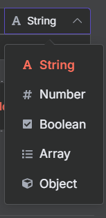

You need to understand about object type later.
For your case, simply add square bracket [ before {{ and ] after }}
Also you need to change from Object, to Array mode
Thanks for your quick response but that’s not my issue. My problem is that a perfectly fine value is available in the input but the node cannot parse it. It just says “undefined”. Even if I go to an earlier node and get it from there it says it’s undefined.
Ah! I got it.
So, you’re using append mode in your Merge node which is make the object separated by array.
(It’s kinda weird tho) Maybe it is a bug?
instead, you can use Combine mode with using combine by the position of node.
I created one example for your case, maybe it will help.
And feel free to mark my message as solution, thanks:)
I came to the same conclusion and combined these. But still funky tbh that this doesn’t work. Thanks for taking the time and look at this. Highly appreciated.
