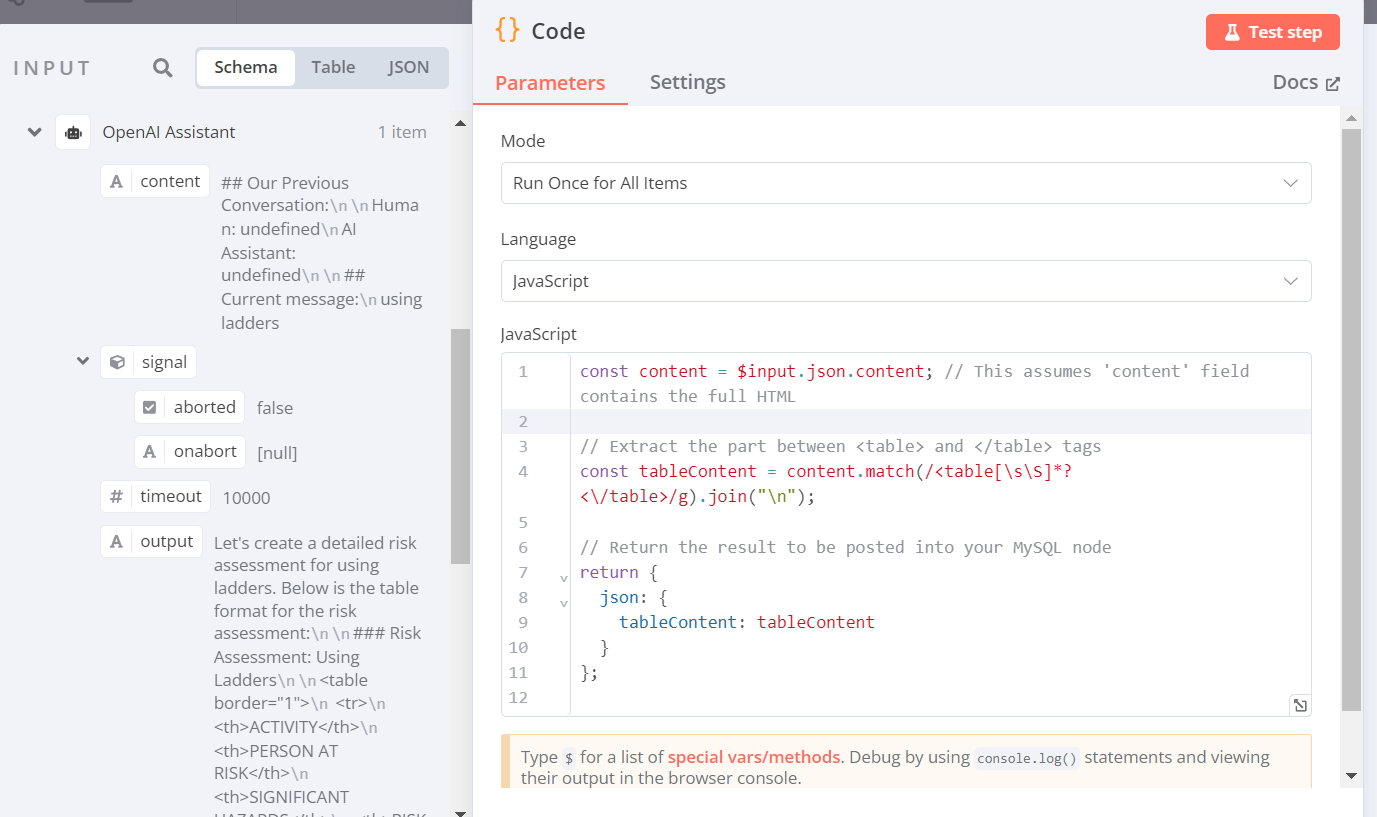

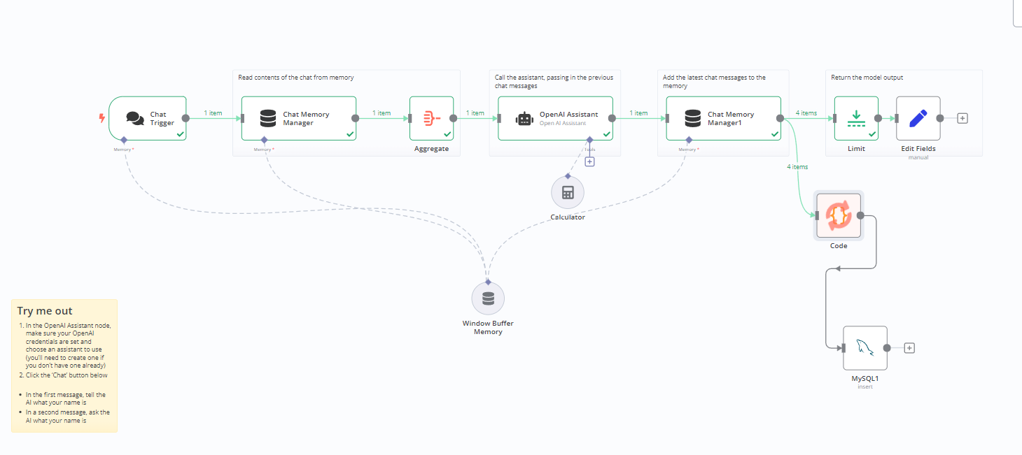

Hi I am using the sample ‘Chat with OpenAI Assistant (by adding a memory)’. I have added a MYSQL node and insert the data from the chat into various fields.
The results contains (usually) the HTML tables and some comment before and after these.

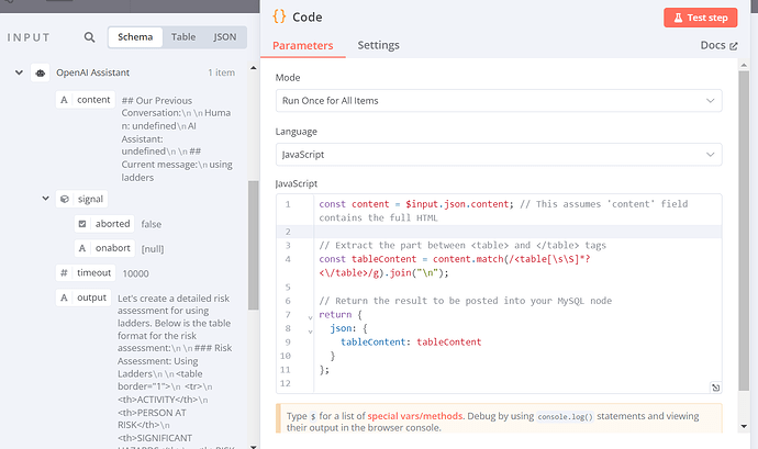

Using chatgpt it gave me some javascript code to get extract just the tables.
const content = $input.item.json.content; // This assumes 'content' field contains the full HTML
// Extract the part between <table> and </table> tags
const tableContent = content.match(/<table[\s\S]*?<\/table>/g).join("\n");
// Return the result to be posted into your MySQL node
return {
  json: {
    tableContent: tableContent
My question is what node do I use to be able to use this code and how please ?
Cheers

I have added the code node. But I cannot drag any of the fields into the javascript code.
How do I reference the ‘output’ value in the javascript.
ie
const content = ‘output’ value
when I change to the JSON output I have

I have the following working in test mode
// Access the output of the "OpenAI Assistant" node
const nodeOutput = $('OpenAI Assistant').item.json.output; // the chat output
const nodeRunID = $('OpenAI Assistant').item.json.runId;
const nodeThreadID = $('OpenAI Assistant').item.json.threadId;
const nodeContent = $('OpenAI Assistant').item.json;
//const nodeQuestion1 = $('Chat Memory Manager1').last().json.kwargs.content;
let nodeQuestion1 = "No question found"; // Default if not found
const chatMemoryItems = $('Chat Memory Manager1').all(); // Get all items from Chat Memory Manager
if (Array.isArray(chatMemoryItems) && chatMemoryItems.length > 0) {
  // Iterate through the items to find the first instance of `kwargs.content`
  for (let i = 0; i < chatMemoryItems.length; i++) {
    if (chatMemoryItems[i].json.kwargs && chatMemoryItems[i].json.kwargs.content) {
      nodeQuestion1 = chatMemoryItems[i].json.kwargs.content; // Assign the first occurrence
      break; // Exit loop after finding the first match
// Check if the output contains any markdown tables (formatted with pipes "|")
let tableReplies = "No tables found";
const markdownTableRegex = /\|(?:.*\|)+/g; // Simple regex to match markdown table rows
const matches = nodeOutput.match(markdownTableRegex);
if (matches && matches.length > 0) {
  tableReplies = matches.join("\n"); // Extract and join the tables if they exist
return {
  json: {
    replies: tableReplies,
    runID: nodeRunID,
    question: nodeQuestion1,
    threadID: nodeThreadID,
    content: nodeContent
I see the test results okay.
When I run it the code node just stays in a loop.
How do I trace this ?
In the executions it says
Workflow execution had an error
Method Map.prototype.get called on incompatible receiver [object Map]
