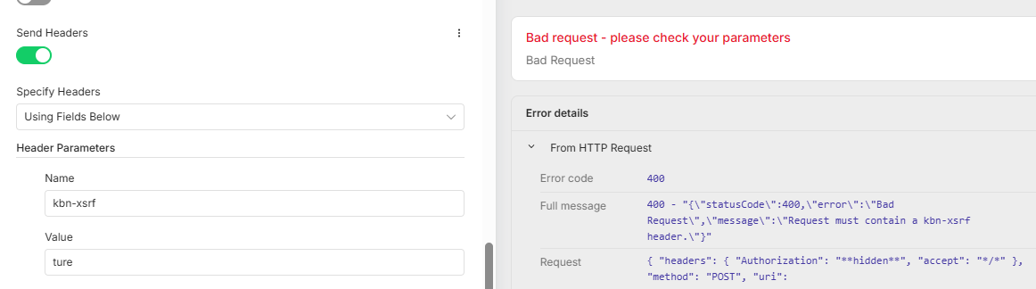

I am working on ELK, I am sending post request to Kibana which require kbn-xsrf: true header.
I am setting this up but still elk is asking for this header.

Hi @Aqeel ,
It looks like you miss spelled “true”

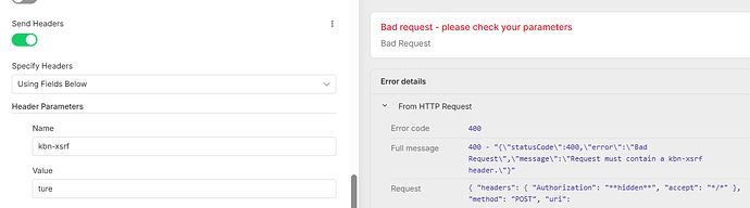

not working,
FYI the cred i am using are of predefined type, elastic security.

Have a look at the Custom auth option and see if this works if you set both headers in there. If the auth requires both headers to be present, then this could resolve your issue
	"headers": {
		"Authorization": "Apikey slirnvlernv",
		"kbn-xsrf": true
However, using header auth and a custom header should also have worked
custom auth is working but credentials are exposed, looking for a way in which credentials are not exposed.
Head auth is not working it only get 1 name and value, i have two value is headers
Who all has access to your n8n instance? Custom auth seems to be your answer at the moment.
