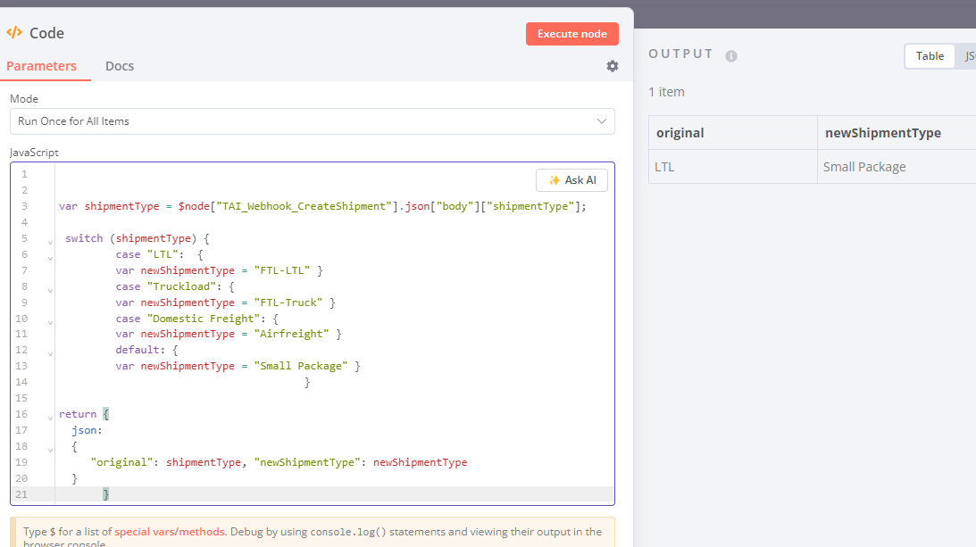

I have tried the below but no matter what the original value is it defaults to small pacjage as the result
var shipmentType = $node.TAI_Webhook_CreateShipment.json.body.shipmentType;
switch (shipmentType) {
case ‘LTL’: {
var newShipmentType = “FTL-LTL” }
case ‘Truckload’: {
var newShipmentType = “FTL-Truck” }
case “Domestic Freight”: {
var newShipmentType = “Airfreight” }
default: {
var newShipmentType = ‘Small Package’ }
return {
json:
“original”: shipmentType, “newShipmentType”: newShipmentType
I would share what im working on but I dont know the best way to do that

I appreciate all the help but for some reason it still is using th default, any other ideas?
Got it working it just needed the ;break value added
ar shipmentType = “LTL”;
case “LTL”: {
var newShipmentType = “FTL-LTL” };break
case “Truckload”: {
var newShipmentType = “FTL-Truck” };break
var newShipmentType = “Airfreight” };break
default: {
var newShipmentType = “Small Package” };break
return {
json:
