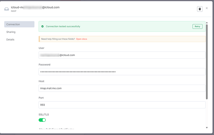

This is my updated workflow. i have removed the unseen option and the email node still does not work. it seemed to work once only but failed at the email summarisation step due to lack of open ai credits. After resolving this by adding open ai credits the node does not work. When i trigger an execution the email node will hang for 30+ minutes, even after i send test emails to it. Do you have any tips to help resolve this? The email node seems to be buggy
Creds are in the green!!
My creds are also in the green!
