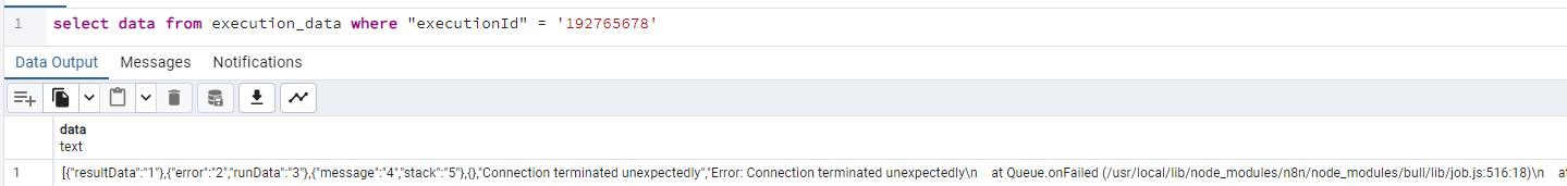

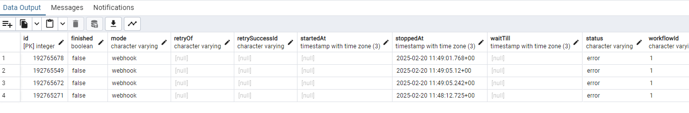

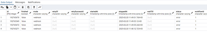

Hello,
I have same issue with the following message return to the “execution_data” table :
[{"resultData":"1"},{"error":"2","runData":"3"},{"message":"4","stack":"5"},{},"Connection terminated unexpectedly","Error: Connection terminated unexpectedly\n    at Queue.onFailed (/usr/local/lib/node_modules/n8n/node_modules/bull/lib/job.js:516:18)\n    at Queue.emit (node:events:530:35)\n    at Object.module.exports.emitSafe (/usr/local/lib/node_modules/n8n/node_modules/bull/lib/utils.js:50:20)\n    at EventEmitter.messageHandler (/usr/local/lib/node_modules/n8n/node_modules/bull/lib/queue.js:476:15)\n    at EventEmitter.emit (node:events:518:28)\n    at DataHandler.handleSubscriberReply (/usr/local/lib/node_modules/n8n/node_modules/ioredis/built/DataHandler.js:80:32)\n    at DataHandler.returnReply (/usr/local/lib/node_modules/n8n/node_modules/ioredis/built/DataHandler.js:47:18)\n    at JavascriptRedisParser.returnReply (/usr/local/lib/node_modules/n8n/node_modules/ioredis/built/DataHandler.js:21:22)\n    at JavascriptRedisParser.execute (/usr/local/lib/node_modules/n8n/node_modules/redis-parser/lib/parser.js:544:14)\n    at Socket.<anonymous> (/usr/local/lib/node_modules/n8n/node_modules/ioredis/built/DataHandler.js:25:20)"]
It’s hard for me to get the error message from container worker because I have 40 workers running and they all are pretty busy. So when I saw the error it already to late to get the log from container (i’m in debug mode).
It’s happend occasionnaly but it’s still anoying because I have to delete the error execution from BDD.
It’s seems to be an issue with Redis but when I go to redis and type “MONITOR” command everything seems normal… I don’t really know what cause the issue…
I’ve still not found any solutions to this issue.
About 0.5% of executions are fail with this error. (About 1500 Executions in the last month on this server)
