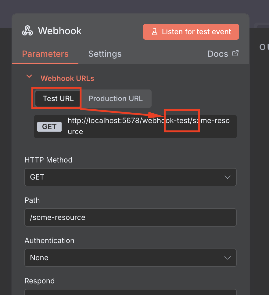

Hi @Jesse_Danku, please note that when you want to test the execution from your 3rd party tool, make sure you add the correct test url with “-test”, otherwise the workflow waiting to be executed will never be fired. You will see there are two urls provided on the webhook node, one for testing and one for production. Make sure you use the correct one.
Your workflow is not hanging, it’s just waiting to be called which will never happen if your 3rd party tool does not use “-test”
My third party tool does use -test. Please watch the video I attached there, I literally show the problem. It’s firing just fine withot the HTTP Node. Here is a screenshot from the video. If the solution was that easy I would’ve solved it already.

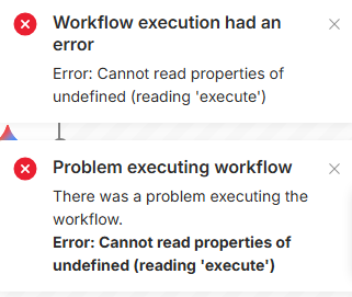

Hi! I’m experiencing the exact same issue, the entire workflow freezes, I can’t execute neither the HTTP or other nodes in the workflow.
I’ll see the node loading undefinitely, then if I check executions, it shows that execution failed in a few (18-40) ms with the following errors:
I’m running self-hosted n8n from a docker image (n8nio/n8n) on runway
I noticed this error in the 1.121.3 version first, then updated to 1.122.1 but didn’t solve anything.
Another weird thing which is also visibile from @Jesse_Danku screenshot is that the HTTP node is not outlined in red as one would expect for a node that caused an error. It’s like the execution doesn’t even start as long as the HTTP node is there (although if I try calling the webhook trigger, it says the workflow has started, even though it actually doesn’t).
If I remove the HTTP node, everything works again.
