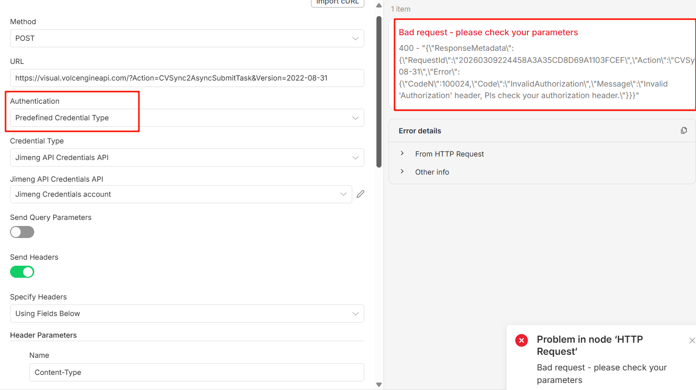

I’m trying to integrate the Volcengine/Jimeng Visual API (CVSync2AsyncSubmitTask endpoint) into my n8n workflow, but I keep getting a 400 Bad Request with the error: "Invalid 'Authorization' header, Pls check your authorization header".
Here is my setup:
  • Node: HTTP Request
  • Method: POST
  • URL: https://visual.volcengineapi.com/?Action=CVSync2AsyncSubmitTask&Version=2022-08-31
  • Authentication: I am using Predefined Credential TypeJimeng API Credentials API.
  • Headers: Content-Type: application/json

Hi @city Welcome!
I guess you should try generating the hash of the signature using the crypto node in HMAC → SHA256, and then pass the resulting signature into the Authorization header of your HTTP request node, although this should work but if you want you can also use code node with crypto lib to generate that, let me know if that works.
