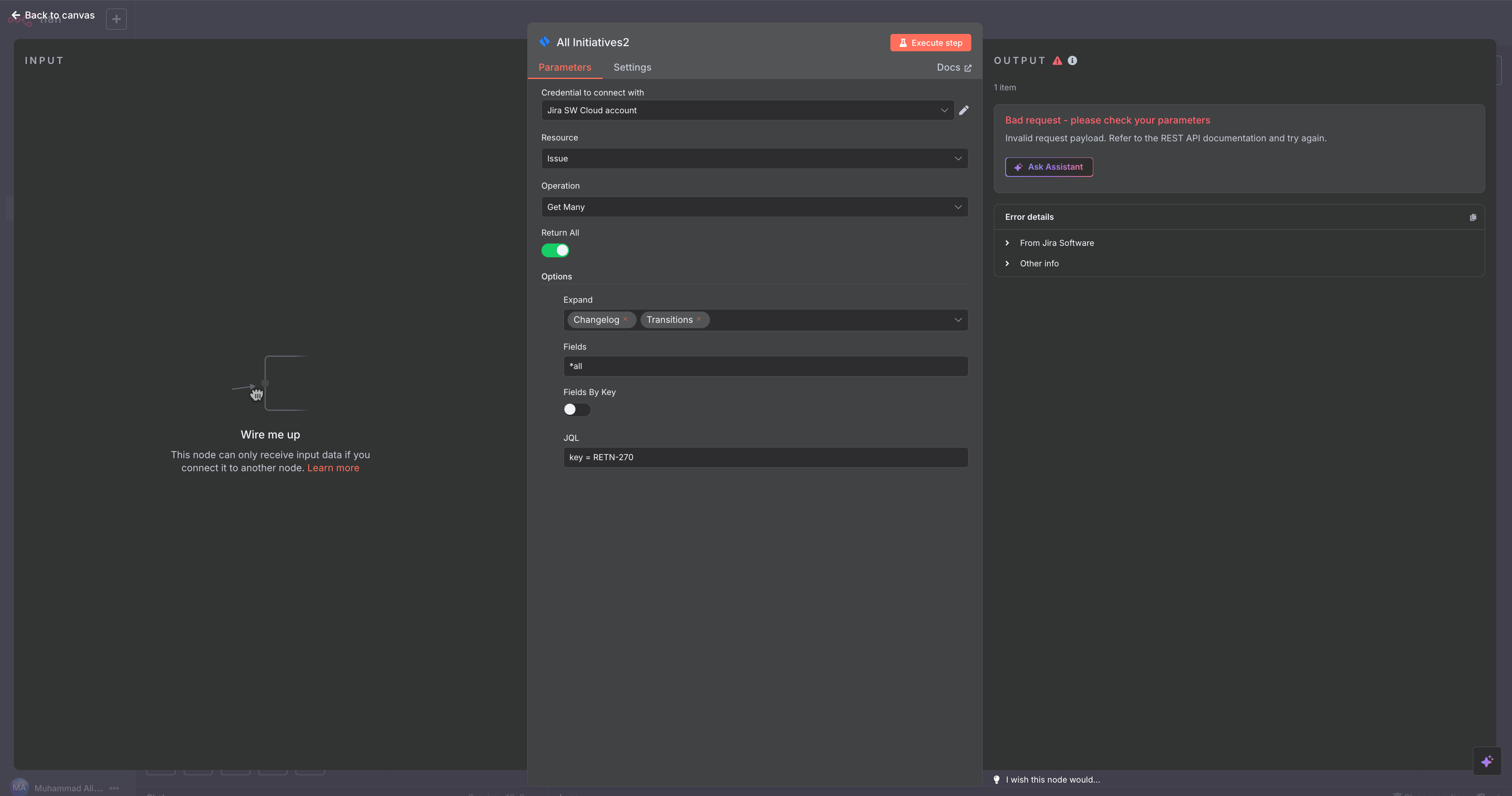

Describe the problem/error/question:
I get ERROR 400 as soon as I use Expand Options in Jira Node. This works ok if I remove the Expand Options.
Full Message:
{ "errorMessages": [ "Invalid request payload. Refer to the REST API documentation and try again." ] }
Single Node Setup. Error shared above

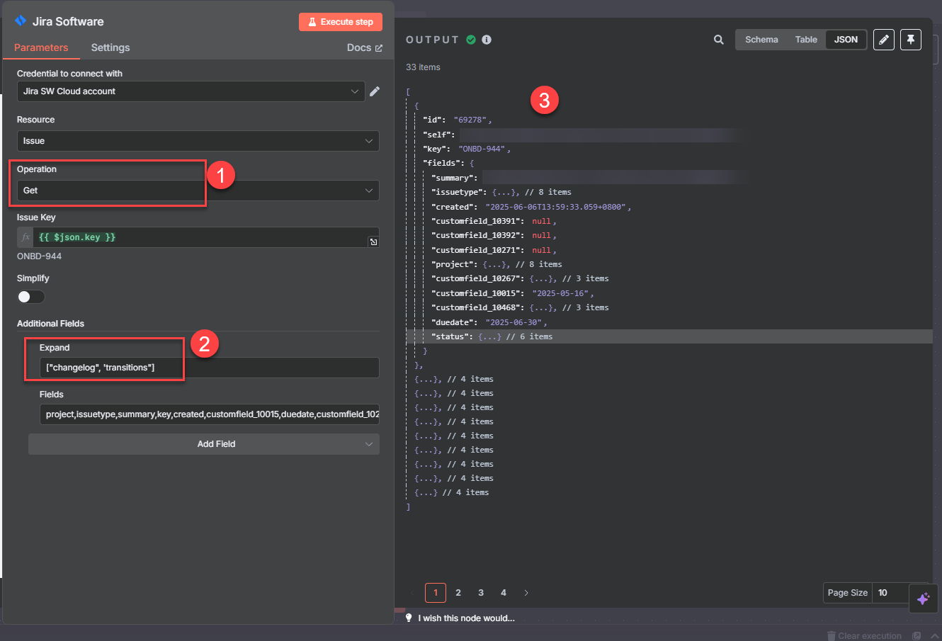

After doing some test.
I think it’a UI bug in n8n node when select get many
From the API document.
It should not accept Expand Options in get many method.
If you need the expand option.
You will need to add a node Get

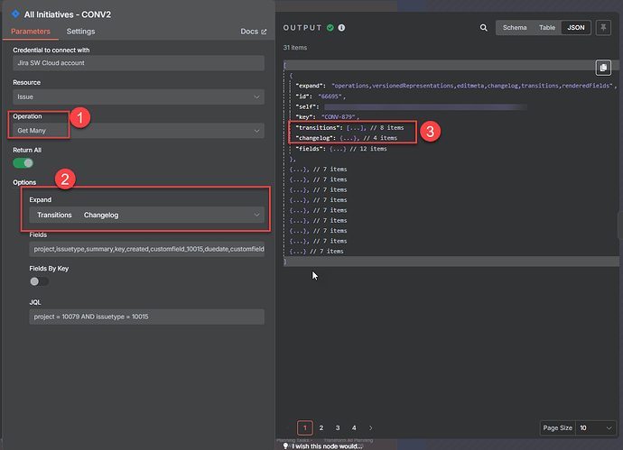

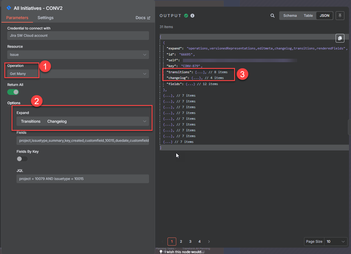

This must have been a recent change in the API. I was using this setup for 3 months prior to yesterday and everything was working fine.
Hoping to get some official word on it but I have not been successful so far.
For a comparison, This is what I previously used to get:
Even with the above suggested solution, I am not able to see transitions and changelog section in the output
Sorry for the expansion part. I re-test and this seems working
This works! Thanks a ton!
