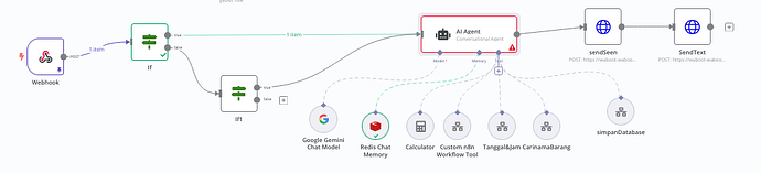

hello guys can you help me for this error,
I plan to enter transactions from WhatsApp chat into the supabase database by training AI as in the picture, but there is an error, please help me
Screen Shot 2024-08-06 at 12.24.31

this error message
Screen Shot 2024-08-08 at 11.28.32
So your AI Agent is missing the input, which could be because of the 2nd If node. Can you try to get rid of the 2nd one and move the criteria into the first?
You know you can combine conditions in the IF node with AND/OR matching.
So where should I start to improve it, sis, this is the workflow
previously the webhook was obtained from a whatsapp message, sis,
Then the 2 if nodes are to identify whether it’s a chat message or group message, so if it’s a group message, the AI ​​doesn’t respond
so where can I add input,
Initially I wanted to enter chat messages into a supabase row from the results of customer chats with AI or are there other instructions, bro
