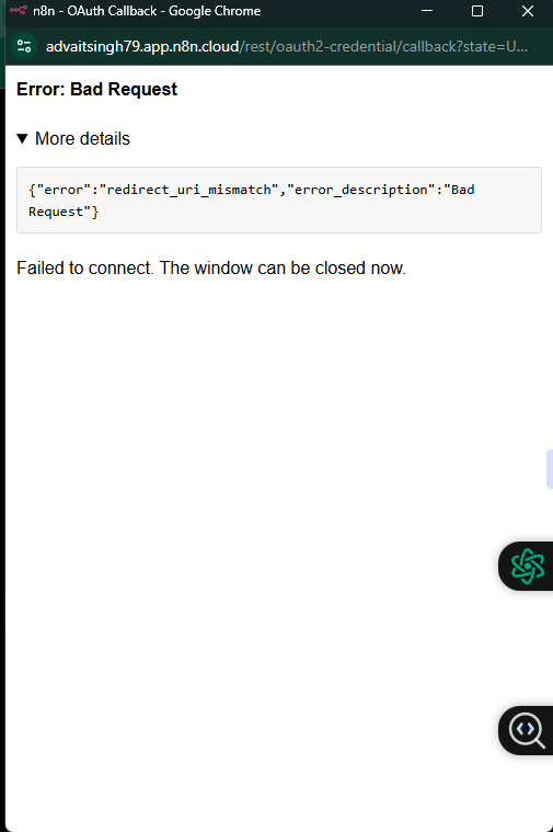

I am trying to authenticate a Google Drive credential in n8n Cloud using my own Google OAuth 2.0 client (Web application).
The Google login and consent screens complete successfully, but after consent, the OAuth callback fails inside n8n with a redirect URI mismatch error.

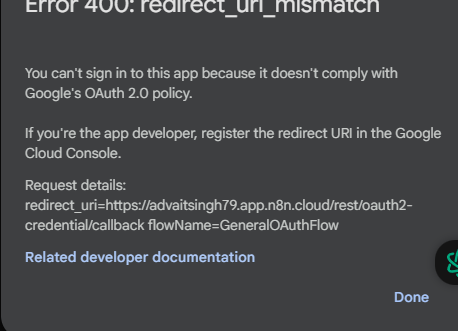

Some important things to note are that n8n recommends to use this URL:
Where in the error logs it is actually using:
So I swapped my redirect URL in google console to use https://advaitsingh79.app.n8n.cloud/rest/oauth2-credential/callback
Yet still after logging in and giving google drive full permission I am getting this error message:

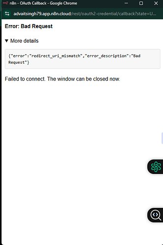

Bad news - I now can pass the initial screen error, but after connecting and providing the permission, then I get this error now.

This isn’t a Google OAuth issue, it’s an n8n Cloud behavior mismatch.
In n8n Cloud, you cannot reliably use a custom Google OAuth client for Google Drive the same way you do in self-hosted. Even if the consent flow completes, n8n Cloud injects its own internal OAuth flow name and state, which changes the effective redirect URI at runtime.
That’s why you’re seeing:
vs
/rest/oauth2-credential/callback?flowName=GeneralOAuthFlow
Google treats those as different redirect URIs. Adding only the base path will still fail.
