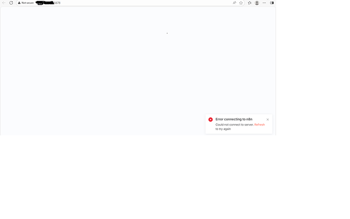

Error connecting to n8n - using Docker on RHEL
Getting “Error connecting to n8n - Could not connect to server” in browser when accessing n8n at http://localhost:5678
Environment:
  • n8n version: 1.120.4
  • Running in Docker
  • Access via Tailscale IP
  • OS: RHEL9.6
What’s working:
  • n8n container is running successfully
  • Server logs show: n8n ready on 0.0.0.0, port 5678
  • API responds correctly: curl http://localhost:5678/rest/settings works
What I’ve tried:
  • Recreated container multiple times with correct environment variables (N8N_EDITOR_BASE_URL, WEBHOOK_URL)
  • Fixed volume permissions (chown 1000:1000)
  • Tried without volumes (fresh container)

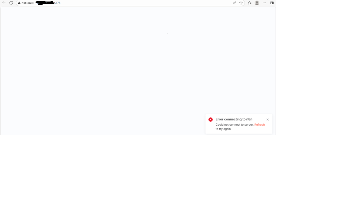

  • Cleared browser cache completely (hard refresh, incognito mode, cleared local storage, service workers)
  • Tried different port (5679)
  • Tried different browsers
  • Error persists across all attempts

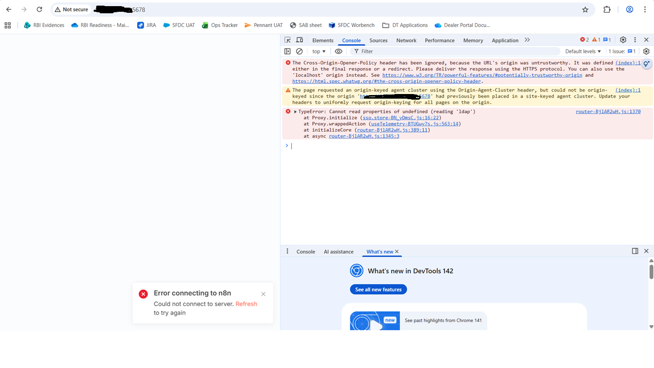

Hey! Since the API works but the frontend does not load, this sounds like a reverse proxy or base URL mismatch. Check if N8N_EDITOR_BASE_URL matches exactly how you access n8n (including protocol and port). If you are using Tailscale IP, set it to something like http://your-tailscale-ip:5678. Also verify N8N_HOST is set to 0.0.0.0 and N8N_PORT matches your container port. Try accessing directly via http://container-ip:5678 to rule out network issues. If still broken, check browser console for specific JavaScript errors blocking the frontend load.
