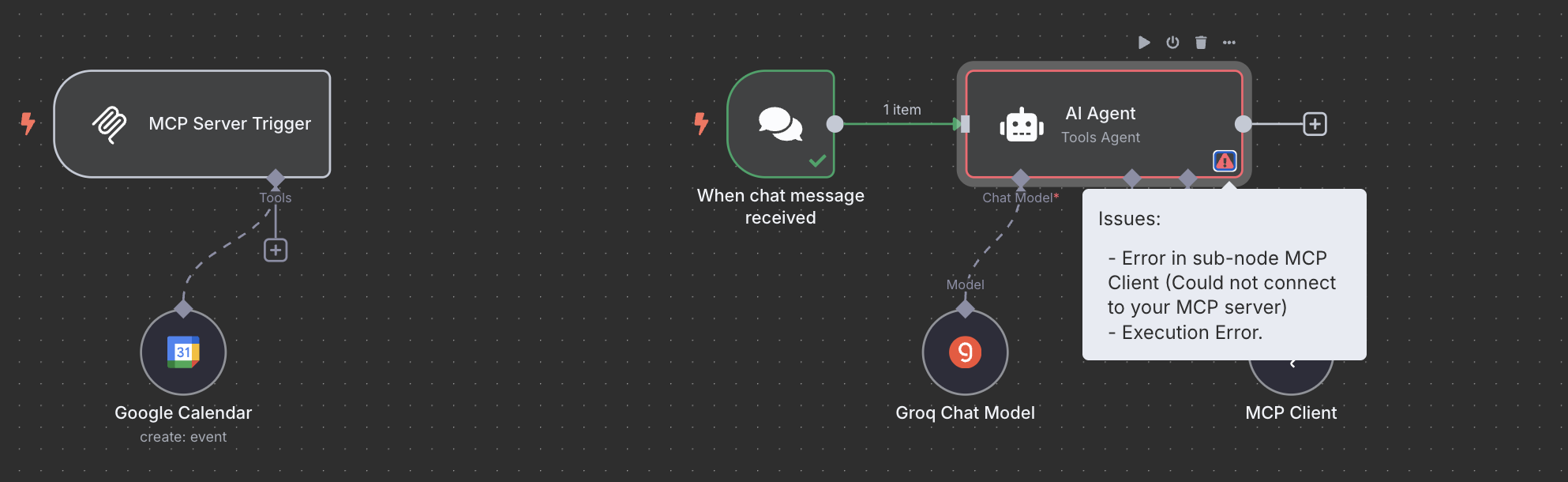

I’m building an automation using n8n and trying to connect an AI Agent to an SSE (Server-Sent Events) endpoint using the MCP Client node.
However, I’m getting this error in the flow:
:cross_mark: Error in sub-node ‘MCP Client’
Could not connect to your MCP server
The endpoint I’m using is public and should work, but I keep getting the message:
“Cannot GET /mcp/teste/sse”
I’m not sure if the problem is with my endpoint configuration or something I’m missing on the n8n side.
Has anyone faced this before?
Any tips on what I should check to make this connection work properly with SSE?
Thanks in advance!

Hey guys, this is a known issue.
It turns out MCP uses SSE connection and that’s a new thing for n8n.
So you have to adapt the infrastructure to treat the connection differently when using MCP.
With Coolify I found out you have to disable gzip compression for the /mcp path, while leaving it enabled for everything else.
That’s also true for traefik and nginx users.

Hello everyone, I managed to connect my client by passing the following URL in the agent tool (SSE Endpoint field): http://[SERVICENAME]:[PORT]/mcp/… Mine ended up something like: http://n8n:5678/mcp/…
this is for using within n8n only but is better than connect via internet.
For those who wants to disable gzip just uncheck this and restart your n8n service:

Thanks @damiao_j, using container name worked for me.
SSE Endpoint:
http://n8n:5678/mcp/{path}/sse
I also tested exposing n8n with ngrok and works fine too.

no i mean it was really similar to what others described, when connecting an MCP client with a local MCP trigger (on n8n) it fails to connect using the production URL. is there another way to do it?
because with external mcp servers, like brave search I managed to connect with STDIO, so yeah I was wondering if there is a simple solution to connect the client to a local MCP trigger on n8n itself
I simply replaced “localhost” with the IP equivalent 127.0.0.1 and it worked

SOLVED: In my case (n8n is hosted in hostinger) the solution was:
1- add the port after my domain
2- due n8n doesn’t have SSL, the url of my MCP Server is http://
3- the example: http://n8n.YOURDOMAIN:5678/mcp/XXXXXXXX/sse
Hoping it helps you.
