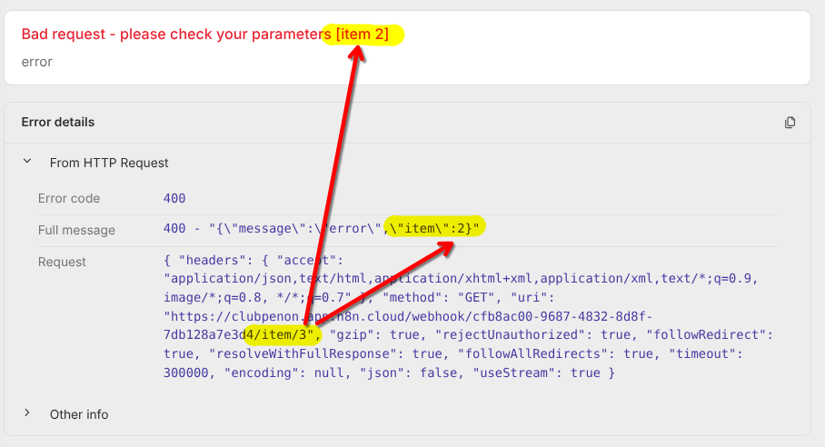

The error details of the HTTP Request node are mixing up data from different items.
Let me explain:
I have a list of items (numbered 1 to 4).
I pass them to an HTTP Request node.
For each item the node sends an HTTP Request (GET /item/:item_number).
For one of the items, the response is an error (in our example it’s item #2).
I open the HTTP Request node and look at the error details.
The information given is the following:
Summary: “Bad request - please check your parameters [item 1]"
Error details > From HTTP Request > Full message: “400 - “{“message”:“error”,“item”:2}”
Error details > From HTTP Request > Request: “{ […] “method”: “GET”, “uri”: “https://foobar.app.n8n.cloud/webhook/random-uuid/**item/3**”, […] }
In short:
  • the summary says the processing of item 1 failed (that’s wrong).
  • the response from the server says the processing of item 2 failed (that’s correct).
  • the request data shown corresponds to item 3 (again, that’s wrong).
The summary always says the issue is with item 1.
The request data appears to be that of the last item that was processed (it’s more or less random).

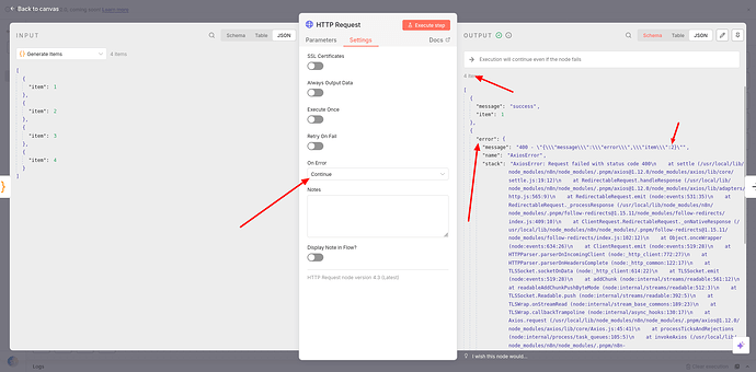

i did not understand your issue.
if you remove 400 bad request from second workflow and always return successfully, when you run the first workflow your http node will output an array that contains 4 items in the same order
@clubpenon
One more thing. if you want all of four request executed and you have the result/error in output. open setting tab of http node and set On Error field to Continue
Here is a screenshot that hopefully is easier to understand.
The error details say that the node failed on the request for item 3, but it’s the request for item 2 that failed, as shown by the main error message and the server’s response.
In short, n8n’s request error details are wrong.
Here is the updated Client Workflow with items indexed to 0 to match n8n error message convention. This makes it crystal clear what the issue is. Run it multiple times and you will see that the request’s reported item number changes randomly (when it should always be item/2).
You are right about URL in Request output of Error log detail.
i set a wrong url for HTTP node that results in 404 always. when i run the workflow 4 http request started and the node waiting for 4 of them to finish, so in my case i get “Bad request - please check your parameters [item 0]” in header because item 0 failed and it is the first item but error detail is for the first http request that finished. so we get different error detail in each run. but it is only in the error log and if pass error message to next node they are correct.
it is a bug to me
