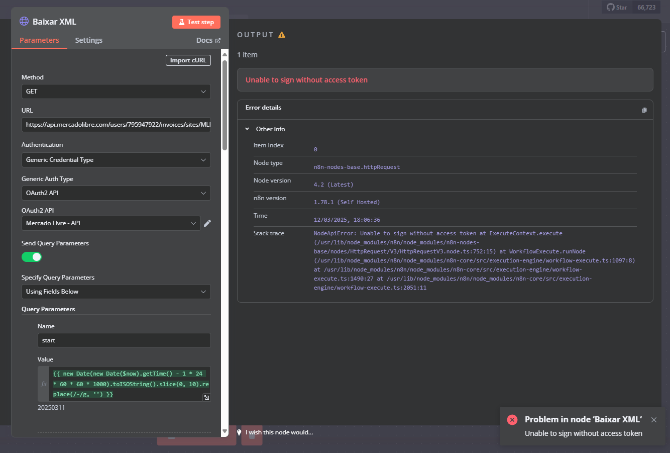

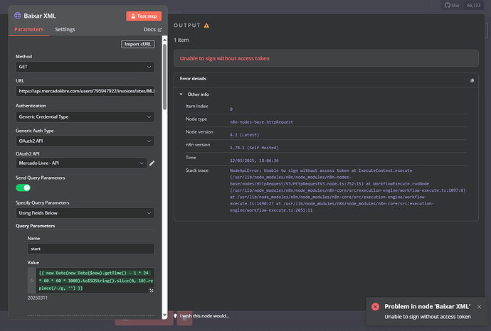

I managed to resolve that error, but I still can’t make the request using generic authentication, I get the error: Unable to sign without access token
Some auth methods require that you exchange more requests to obtain a token.
From what I can see in the documentation, you have to send the header token in EVERY request.
So choosing the genetic credential is not enough. Your also have to add the token in the header.
Maybe you can have the OAuth2 credential and the header token at the same time. Not sure.
But sometimes you need to execute the auth process entirely in the workflow, without using n8n credentials at all.
Let me know if you can figure that out.
I always ask ChatGPT to explain and build the requests for me, by asking for the URL, headers and body separately, instead of the cURL. And he nails it every time.

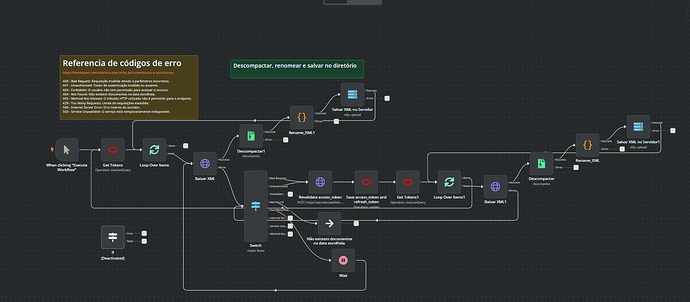

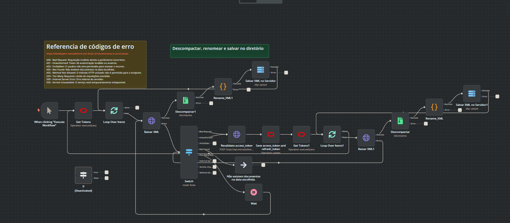

The way I managed to solve the problem was by creating a workflow to generate the tokens.
I thought that N8N’s Generic Credential Type would make this whole process simple, without having to create this whole flow to generate the tokens.
