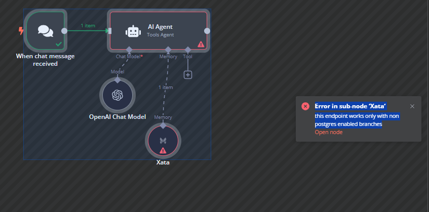

Error in sub-node ‘Xata‘ this endpoint works only with non postgres enabled branches
Hey folks, I added the Xata memory node in the AI agent, and i get the error
Error cause: Erron in sub-node ‘Xata’ this endpoint works only with non postgres enabled branches.
Blockquote
{ "status": 400, "errors": [ { "message": "this endpoint works only with non postgres enabled branches", "status": 400 } ], "requestId": "29840bd0-7558-9afb-a569-deba09cd4c8e" }

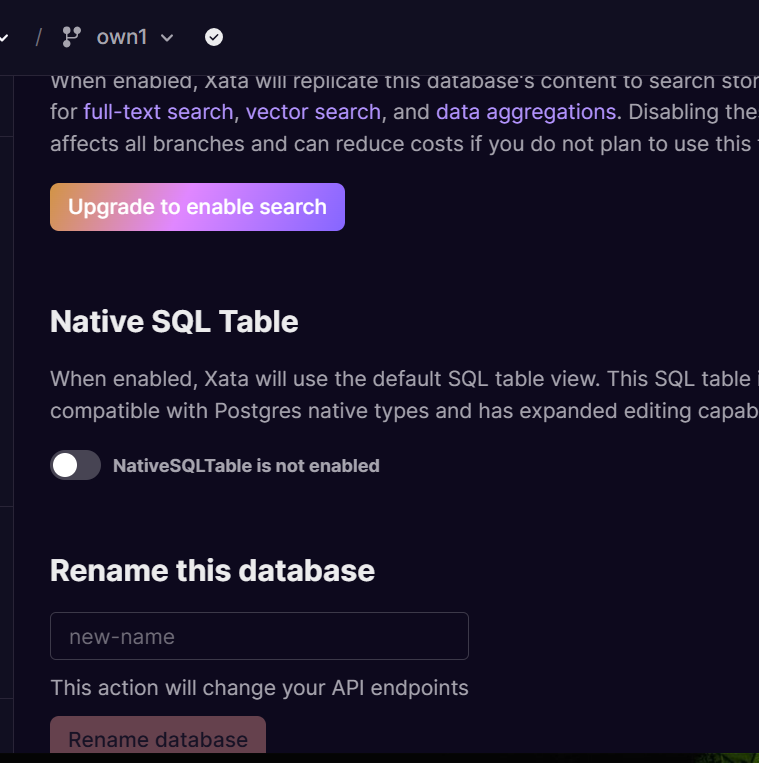

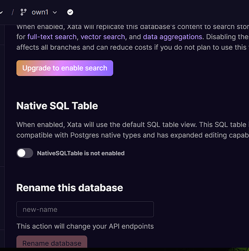

while my branch is not postgres enabled
My branch in Xata is not enabled, done already 5 times, checked and rechecked

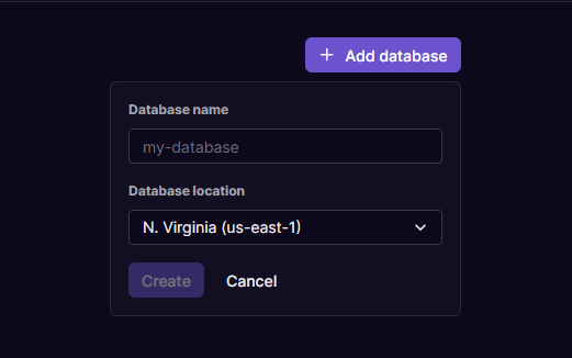

I was having the same issue, you need to unmark the “Enable direct access to Postgres” when creating the DB. What I did was create a new database and change the “Database Endpoint” in my Xata credentials and it worked!
thank u alvaro!!! i am gonna try it and gonna return back to u
hey alvaro it worked <3
:sweat_smile:
This is happening to me as well but the option to Enable direct access to Postgres is now missing. It looks like it was enable by default now.
