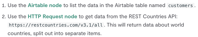

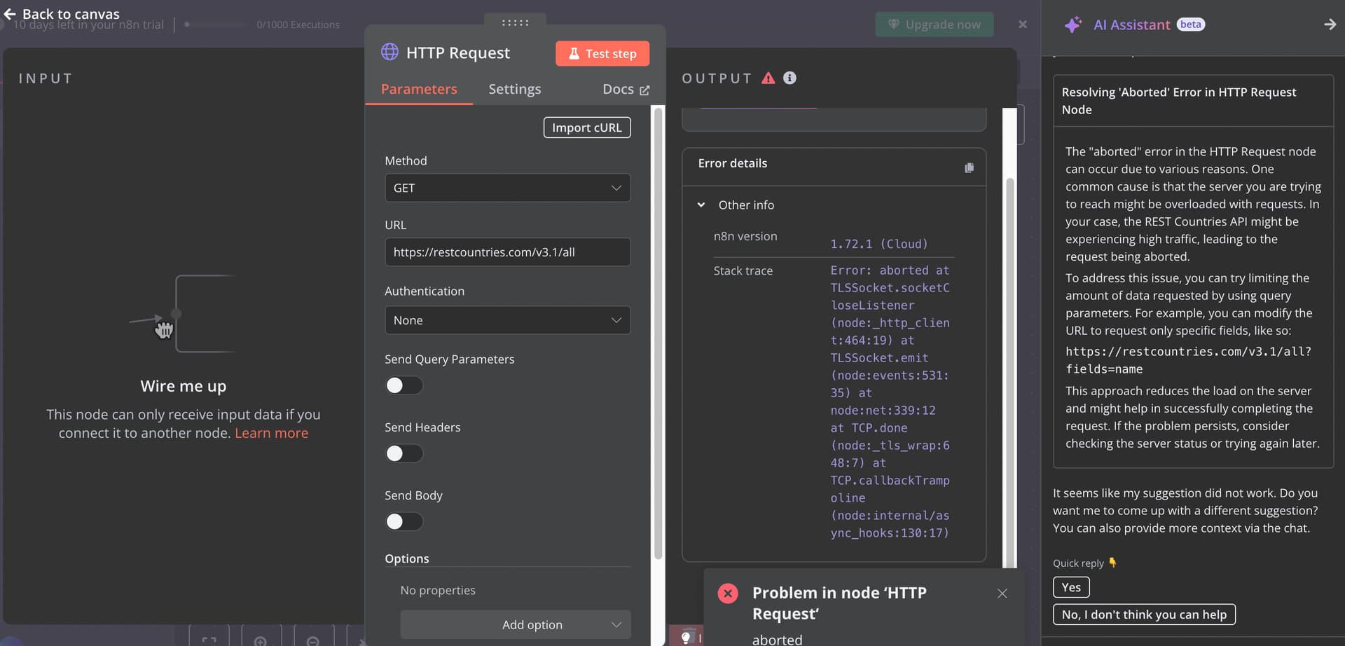

hey guys im doing the level-2 course. any ideas what i did wrong here? can’t seem to get the api working. or is it the link itself that has problems? maybe anyone that did this course can help
right so it is:
  • n8n version: Running version [email protected]]
    Database: SQLite (default)
    n8n EXECUTIONS_PROCESS setting: own (default)
    Running n8n via: n8n Cloud
    Operating system: macOS
    Browser: Google Chrome
Hi @ihsanific
There is an error in the rest countries api that has been reported. Use the following in the GET request and this should return the data you need to proceed:
https://restcountries.com/v3.1/all?fields=name,region,subregion
