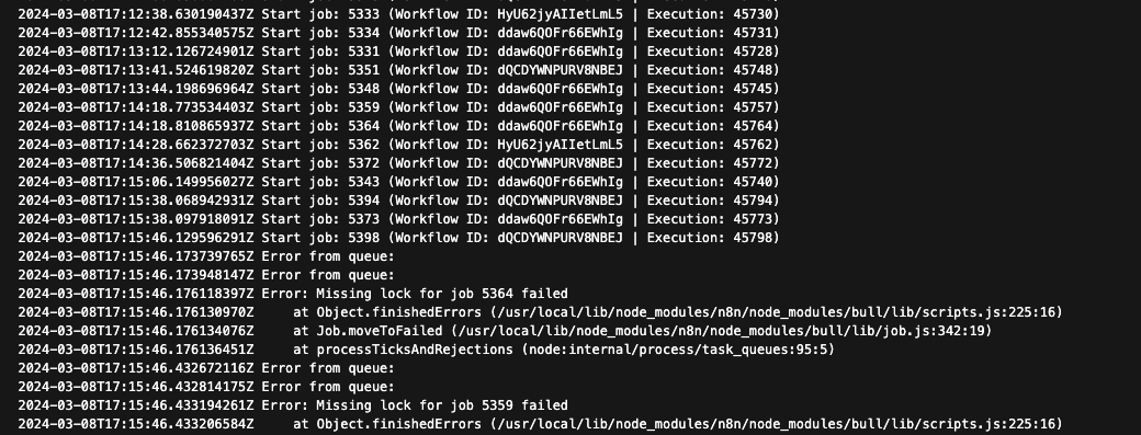

I’m intermittently losing json from some of my streams
the flow gives an error and when I look, there is no information
Below is the log that appears.
what could be causing this? Can anyone give me some direction?

I asked around with some folks that know a bit more about queue mode.
Consensus is that it’s likely resource related, check to see if you’re running out of memory
Thank you very much for helping me, what you said makes sense, sometimes this message from RabbitMQ arrives with a base64, I believe that the data can become very large and generate a memory overflow, I will try not to pass this base64.
But, one question, would I run out of memory, in the webhook, in work or in RabbitMQ?
