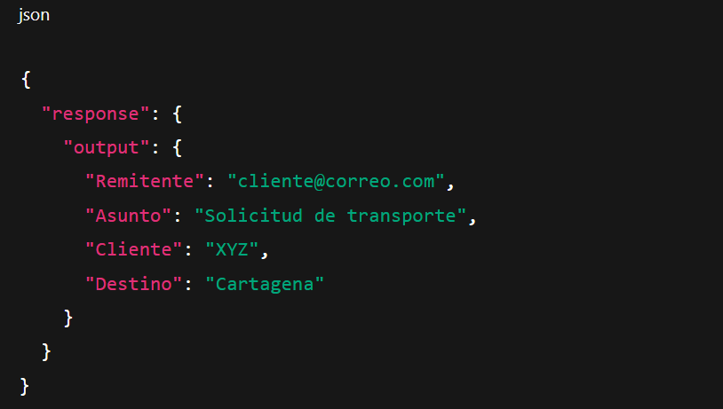

In the output of Structured Output Parser.1 I can clearly see my structured JSON inside response.output, for example:

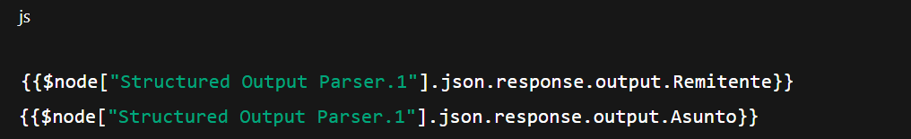

In the Edit Fields node, I’m trying to use expressions like:
But since Edit Fields is only connected to the Basic LLM Chain, I either get undefined or the “main input” error.
