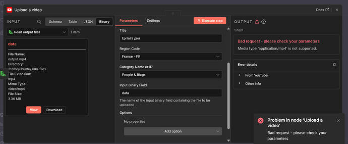

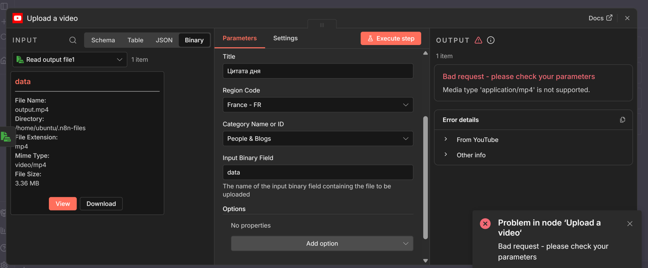

Hi. Please tell me how to fix this error. I’ve tried everything, but the file was created using FFMPEG and is on the disk. I specify the mime type when receiving it, but YouTube still sees it as an application, not a video.
Does your ffmpeg produces a standard MP4 or you are later converting to MP4 ?
It seems that your ffmpeg is generating the file with MIME type as application/mp4 instead of video/mp4. Can you check that.
The file properties indicate that it is an MP4 video. When loading the file from disk, it also indicates that the file is a video\MP4.

Everything worked without any issues. It grants all the required permissions and isn’t picky about access. It does give an error about the file type. Incidentally, the same video can be manually uploaded to the site without any problems. The issue arose with the version update before 2.0.
:six: Possible cause: a bug in n8n v1.122.4+
If you’re using this version, it’s a known bug, and the solution is:
Upgrade to the new version: npm install -g n8n@latest
OR wait for a patch release instead of using HTTP Request
