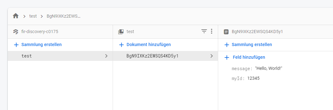

Hey @bocaz , I have tested the firstore node yesterday and could confirm the project ID dropdown problem. I have added this to the bug report.
That said, the node still works fine when testing this using a workflow like so:
The node runs fine:
And the document is shown in the Firebase console:
Any chance you can share your workflow so I can reproduce the problem you’re having?
