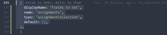

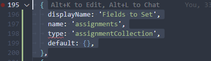

Error: Type '"assignmentCollection"' is not assignable to type 'NodePropertyTypes'.ts(2322)
I am building a node that needs a UI that takes in an object and i have found this property
the issue is that error. Am i gonna be able to publish this node?
to tst it on my local i have modified my node modules to
this just adds that type but only on my local and the error is gone
Is it ok to use it or there is a better node property that will get me an object, I have tried the Json type and its returning a string its not doing what i want.

Hi @Onlypfachi
not sure I can understand what’s going on here… I thought that the
NodePropertyTypes are declared in the interfaces.ts - are you trying to overwrite them?
assignmentCollection is missing in the NodePropertyTypes
