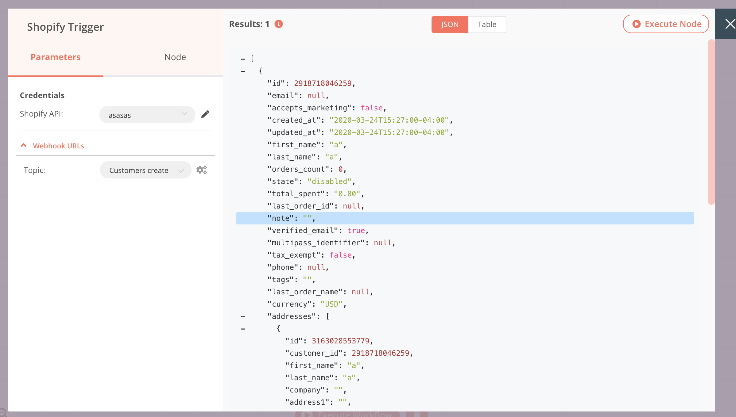

@jan @RicardoE105 the “rawBody” property is undefined, could this be part of the issue?
@tjenkins just to make sure. Does the error happen when you receive the event?

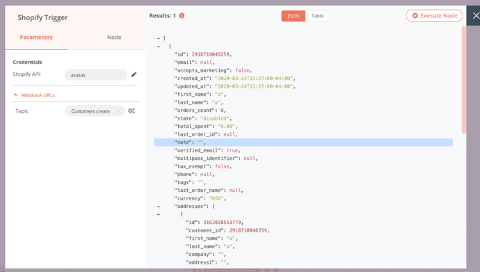

Make sure the under shop subdomain you are adding the just the subdomain and not the complete url
My complete url is: https://n8n-105.myshopify.com, the subdomain part it’s just n8n-105
It’s working perfectly for me.
