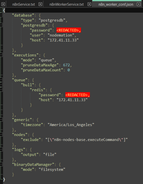

Please see attached and let me know if you have any question (yes, I am aware that is in the public address space :melting_face: the AWS VPC was set up that way by my predecessor, but the traffic is internal).
notepad++_4ssVCtWsV1
notepad++_G7NzUAe2Lt
I have yet to test the --ignore-scripts as advised above.
Also going to have a look at the Schema file again, could be due parameter changes (removed, added made new default) that’s messing with it.

Hey @K3N,
The globalroleid will be a database migration issue I would make sure all of your instances are on the same version and at least on 1.27.2 which should fix the database issue.
The other issue you will see is your main n8n instance does not have the encryption key env option set which is needed.

Hey @K3N,
I would set the encryption key on the main instance as well just to make sure it is correct. In 1.25.0 we made a change to error if the env option didn’t match the file. The below is aken from our breaking changes document, I am not sure why this didn’t make it to the release notes, We may have updated the breaking change file after the release notes were put out.
Did you have a chance to set this and update to 1.27.2?
What changed?
If the N8N_ENCRYPTION_KEY environment variable on a main instance does not match the encryptionKey in the config file, the main instance will not initialize. If the N8N_ENCRYPTION_KEY environment variable is missing on a worker, the worker will not initialize.
When is action necessary?
If passing an N8N_ENCRYPTION_KEY environment variable to the main instance, make sure it matches the encryptionKey in the config file. If you are using workers, pass the N8N_ENCRYPTION_KEY environment variable to them.
