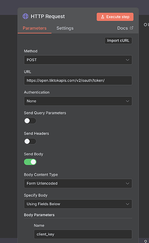

I ran into the same issue where TikTok’s OAuth2 URLs expect client_key instead of the commonly used client_id.
I initially solved this by manually adding client_key as a query parameter inside the OAuth2 credential configuration.
However, I found that the Access Token URL also requires client_key which made the built-in OAuth2 credential unusable for TikTok.
So instead, I implemented a workaround without relying on n8n’s native OAuth2 credential, and it works perfectly:
My Working Solution
1. Create a dedicated workflow for TikTok OAuth authorization
This workflow is triggered by a Webhook node.
I used the Webhook URL as the OAuth redirect_uri inside my TikTok Developer App.
2. Build the TikTok Authorization URL manually
https://www.tiktok.com/v2/auth/authorize/?client_key=YOUR_CLIENT_KEY&scope=COMMA_SEPARATED_SCOPE&response_type=code&redirect_uri=YOUR_WEBHOOK_URL
When I open this URL in the browser and approve the permissions, TikTok redirects back to my webhook with a code parameter.
3. Extract the authorization code inside the workflow
Once the webhook receives the request, I parse out the code from the query parameters.

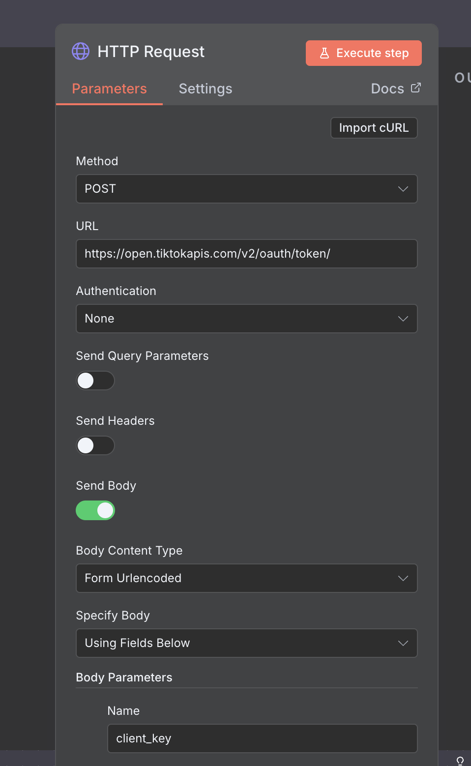

4. Exchange the code for Access + Refresh tokens
I send a simple HTTP POST request to TikTok’s token endpoint:
https://open.tiktokapis.com/v2/oauth/token/
with form-urlencoded parameters (including client_key, client_secret, code, and grant_type=authorization_code).
5. Store the tokens
After receiving the Access and Refresh tokens, I save them in a Data Table.
This allows me to reuse the tokens from any other workflow.
Whenever I need to re-authorize, I open the same authorization URL again and approve the permissions.
Result
This approach completely avoids TikTok’s unusual OAuth behaviour inside n8n’s generic OAuth2 credential and gives me a clean, reliable authorization flow.
The redirect_uri is also needed as a parameter
You can use your n8n WEBHOOK URL as redirect_uri
Yes, and it is what I did. Your message was very precious help. Thank you. My comment was about the required parameters at step 4. My first try didn’t work because the redirect_uri is also one of the parameters to send when exchanging the token : with form-urlencoded parameters (including client_key, client_secret, code, and grant_type=authorization_cod, and redirect_uri).
