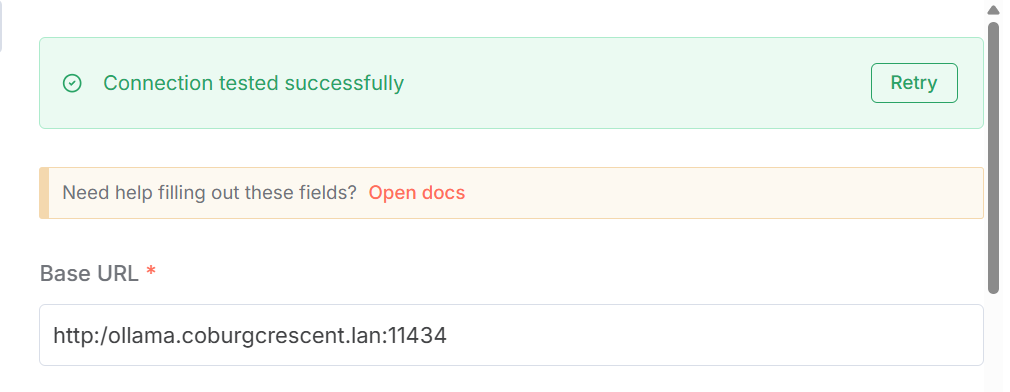

Hi there! Thank you for the response. I’ve tried to update the base URL with v1 and I get the following error:
However, when I remove the V1, it works
When I try typing the curl command, it looks like it works
