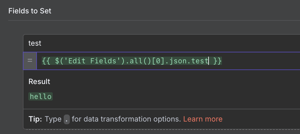

Also the expression you are sharing here looks wrong.
Corrected here

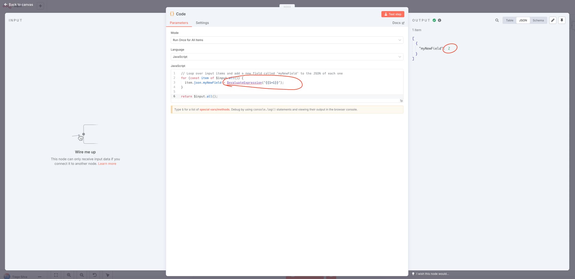

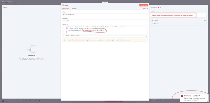

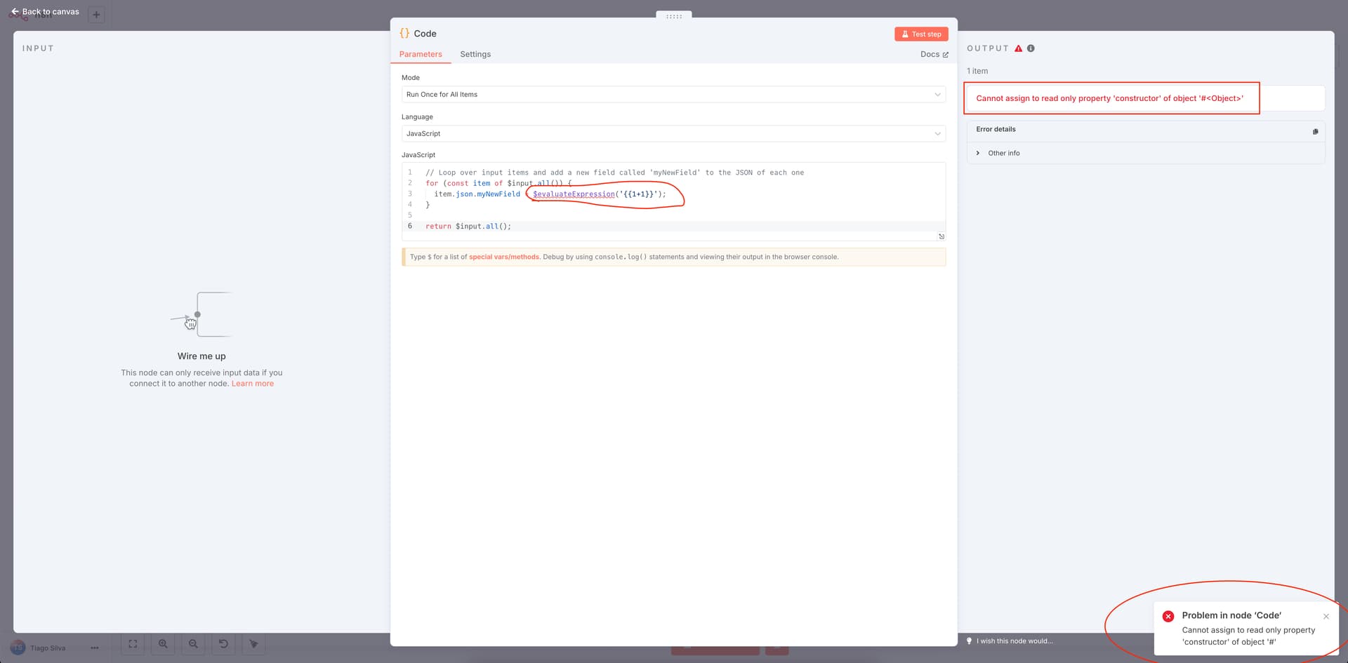

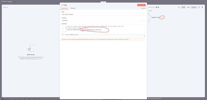

The problem occurs when we call the function directly inside a Code step. When attempting to use it, the function doesn’t return the expected results, as you can see in the attached evidence (screenshots/prints) provided in this reply. :paperclip::framed_picture:
Please let me know if you need any further information or clarification to help resolve this issue! I’m happy to assist in any way I can. :rocket::sparkles:
Thanks again for your support! :yellow_heart:
N8N_RUNNERS_ENABLED=false
N8N_RUNNERS_ENABLED=true
Thanks for sharing the example.
Sorry I completely misunderstood the problem. Will tag this as a bug internally and tackle it soon.
