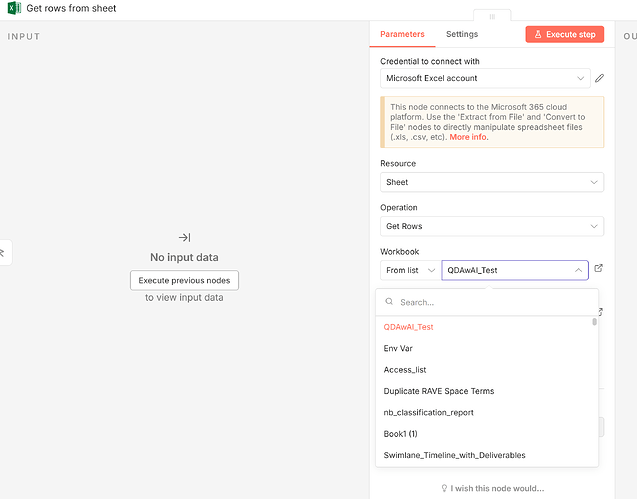

I want to access an Excel file stored in SharePoint. I set up credentials for M365 Excel. It seems to be working, but there are some issues:
  1. Can I limit the files it has access to? Perhaps by selecting a folder or using a path? It seems to be connecting to every single Excel file I have ever made. I have been at this company for 10 years. That is a lot of Excel files!
  2. Is there a limit to the number of files it can read?

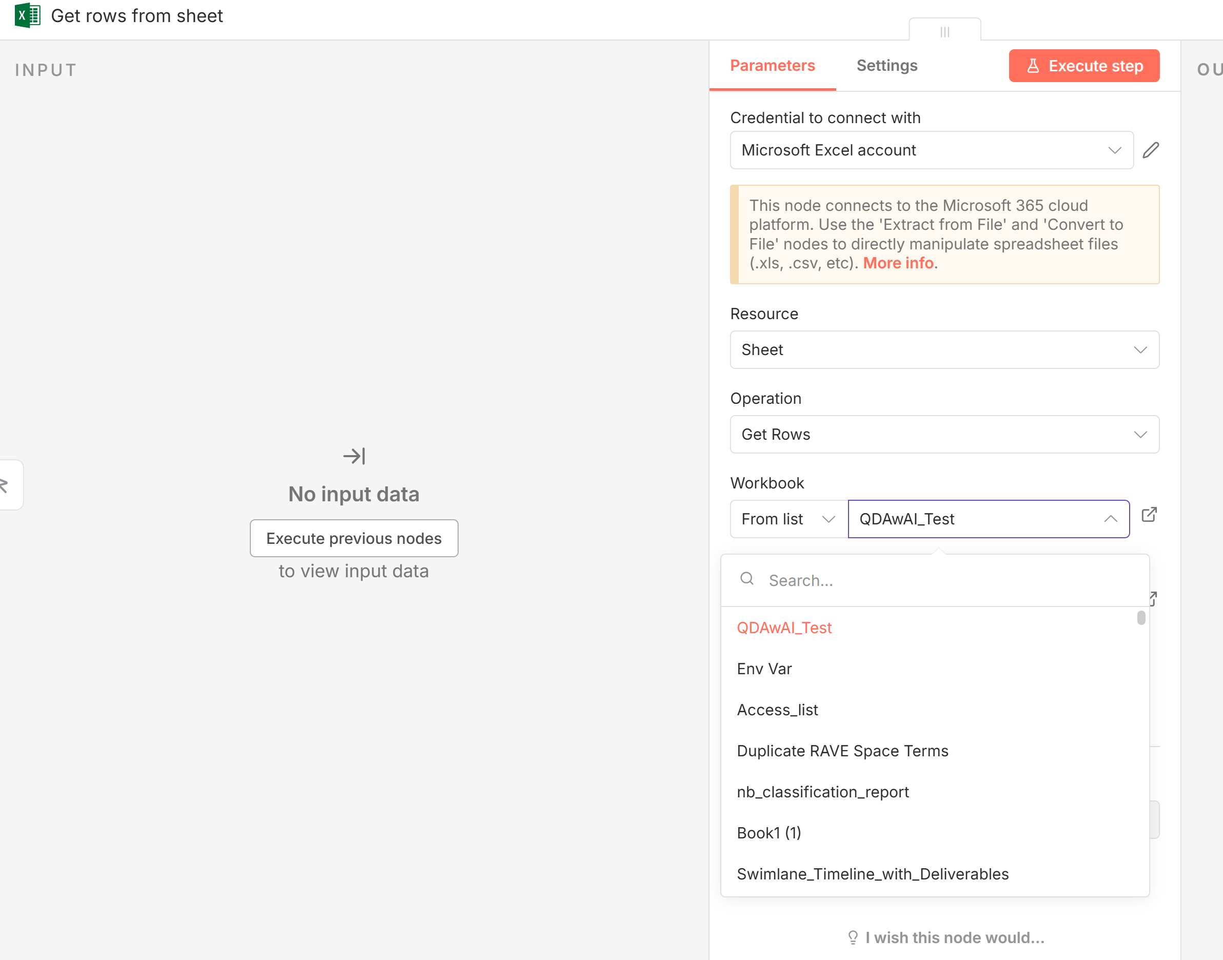

  3. I have seen files that I have previously used in the Get Rows from Excel node, suddenly become available. For example, they were in the dropdown From List in the Workbook section and are no longer there. In the example below, the file QDQwAI_Test.xlsx file is still in the same location, but is no longer available to select.
n8n version: 2.0.3
