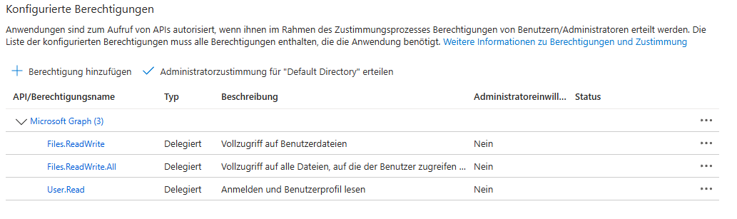

I gave my app the Files.ReadWrite permission scope as written in the docs:
My spreadsheet is saved in my personal OneDrive, and I’ve double checked that it’s the account authorized with n8n.
I’m really clueless what I’m doing wrong :sweat_smile:
what’s inside the three dots on the right on the permissions page? Is there an option to grant permission?
Nope, I’m only able to revoke the permission there :sweat_smile:
