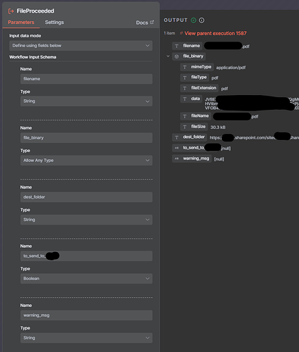

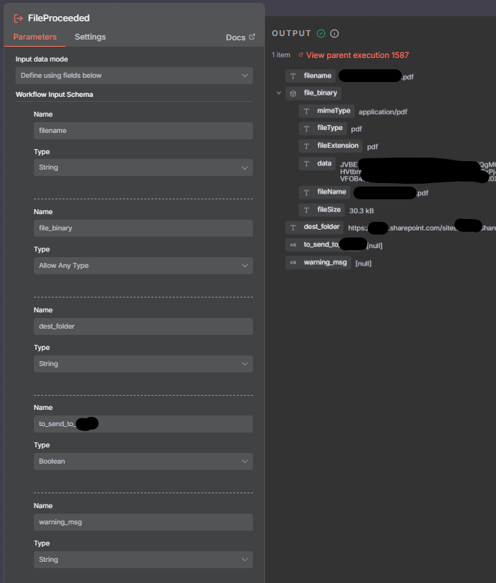

I have a master workflow which call a sub workflow at its end.
The Sub workflow receive data but not all the parameters
The “to_send_to_xx” does not receive anything.
I tried to change its type but it is same issue.
We can see in the sub workflow that this parameter is defined to Boolean but the Output displays it as Sting.
Any clue ?
No error
Master workflow ends with
Sub workflow starts with
“filename”: “xx.pdf”,
“file_binary”: {
“mimeType”: “application/pdf”,
“fileType”: “pdf”,
“fileExtension”: “pdf”,
“data”: “JVBERi0…UVPRgo=”,
“fileName”: “xx.pdf”,
“fileSize”: “30.3 kB”
“dest_folder”: “https://xx.sharepoint.com/sites/xx/Shared%20Documents/General/xx”,
“to_send_to_odoo”: null,
“warning_msg”: null

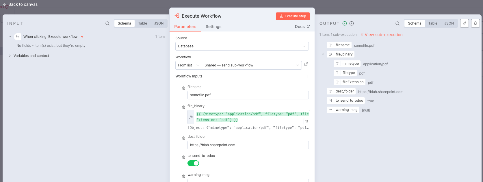

This appears to be a bug because the default value of that parameter is “on” but the output value is actually null.
The workaround is to simply toggle it off and back on again. When on the boolean value is set to true correctly.

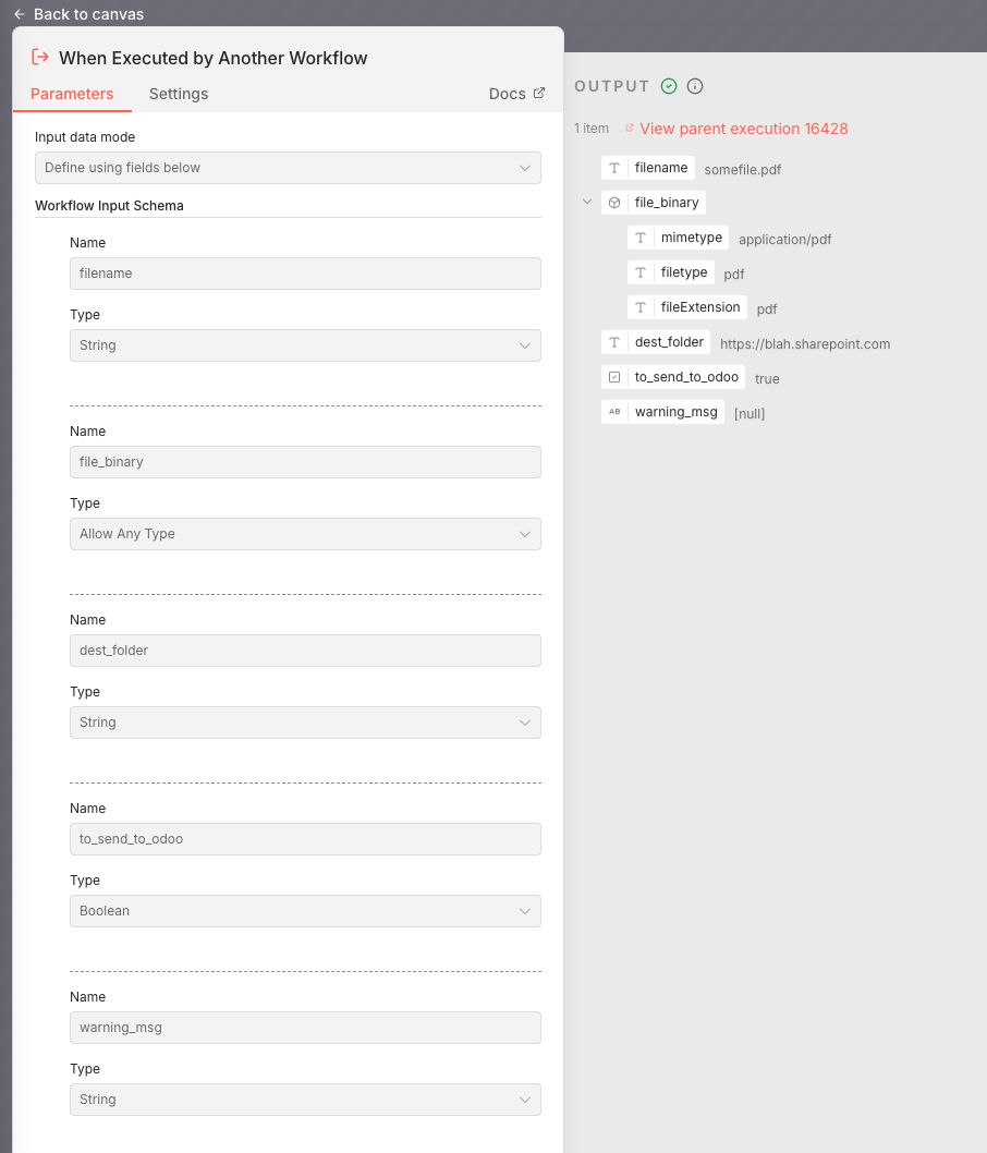

It seems your screenshot if about the Master workflow and not the sub workflow.
Do the sub workflow receive data correctly ?
On my side, apparently, data are correctly sent but not correctly received.
Unfortunately, toggle the variable did change anything :frowning:
Best regards

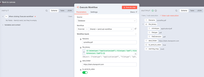

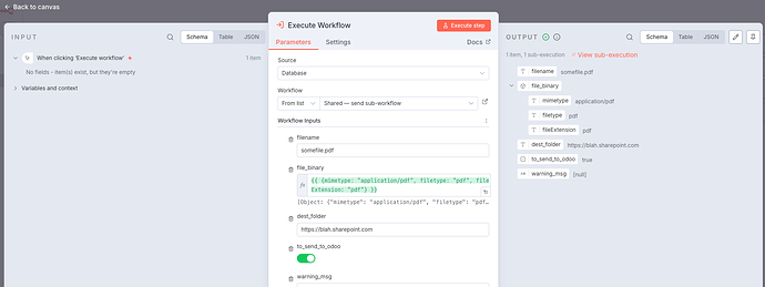

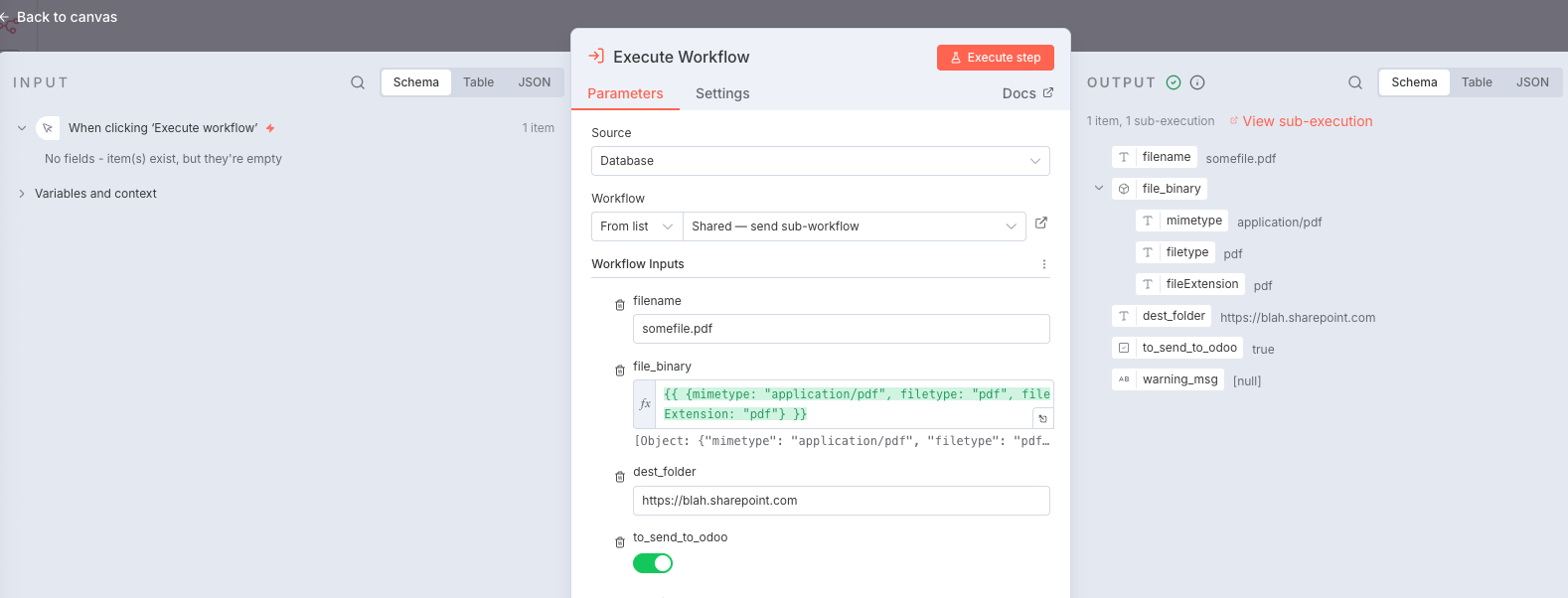

Yes it does. I’ve re-run it and the value does get passed correctly from the parent to the child workflow.
Here’s the parent workflow execution.
and here’s the sub-workflow that’s associated with it.
And I’ve found the relevant bug associated with the initital state.
Thank you for the link : Boolean field in sub-workflow input shows as enabled but is actually null · Issue #20149 · n8n-io/n8n · GitHub
