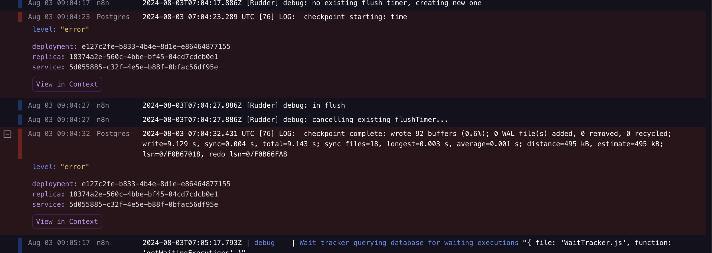

Got this error in my Railway console:
and:
I’ve the exact same problem on another workflow as well.
