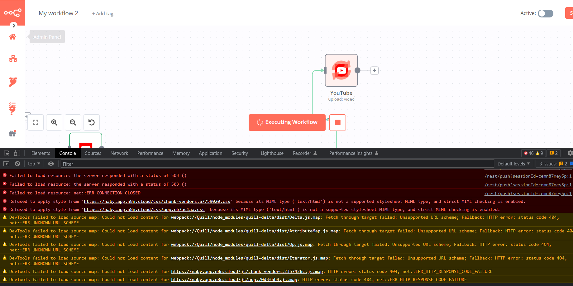

So everything before the final node is running but when it gets to final flow(upload video) its stuck there.
Hey @Explain_Me,
It may just be taking time to upload or if the video file is large the instance could be running out of memory. If you open the browser dev console do you see any error messages?

Hey @Explain_Me,
That looks like it is probably a memory limit you are hitting. How big is the video?

Found it its 43.7 MB and max will be below 100Mbs for my every other video
mmm I would have thought it would have been ok, Do the other videos upload ok?
no none did. I retired with different videos under 100Mb they all get stuck
Can you DM me your cloud username so I can take a look and see what the log says?
