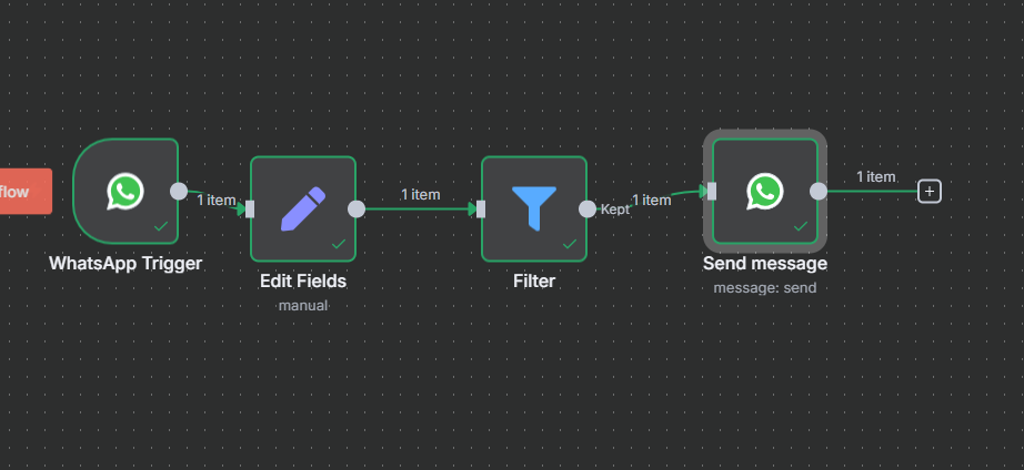

I am using n8n online

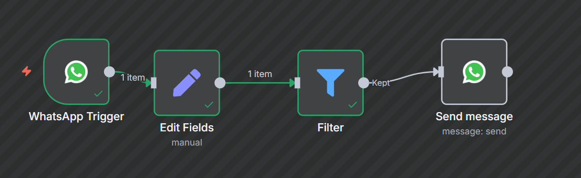

this is my workflow

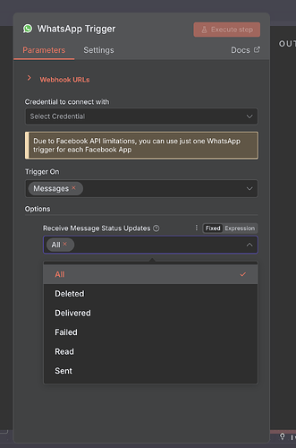

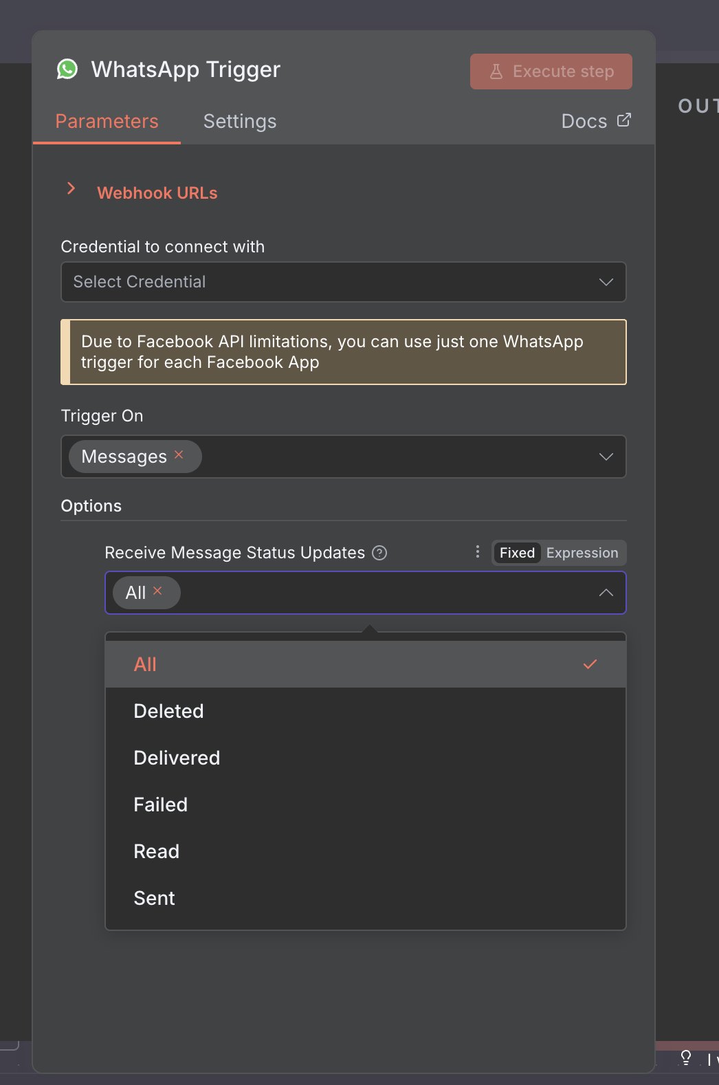

Hi there, i think this issue happens because the way of how the whatsapp Trigger gets triggered
By default,the whatsapp triggerd - On Message, gets triggered for every event that is happening on the message (message gets deleted, delivered, read, failed,sent], so most likely, the whatsapp trigger got triggered for one of those event where they do not provide the json message text body, which what you are looking on ur filter node
if you only want it to be triggered on a certain event only, like lets say only when its delivered, then you can set it up here

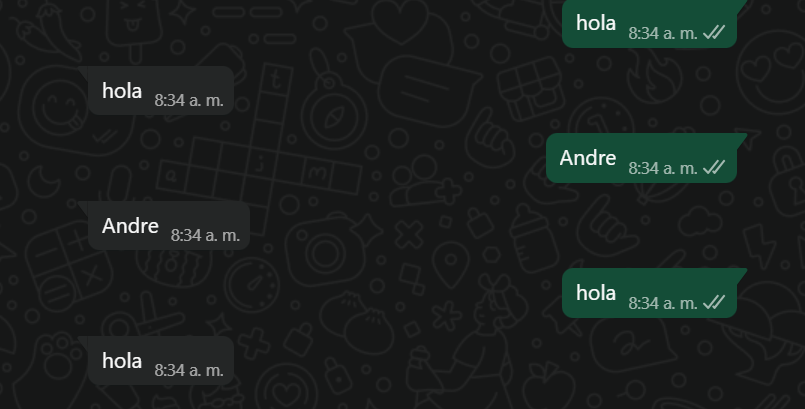

After this I said ok it will work, but i put active and i make some test
okay that work well. Now let see the excutions
there is not the bodymessage but i mean it not make sense. in the whatsapp chat the “bot” send to me the message so in the excutions must show me that everything is fine but this is not the case.
Hi there @Eliot ,
then let’s dive in a little deeper, can you give me a screenshot of the failed executions, give me the screenshot of inside the whatsapp trigger and let’s see how the data looks like and why is the message body is not there
my guess is that the whatsapp trigger is still executing on some other events
especially because it’s in production mode, where it’s hearing all the events always, all the time,
where its different when you test it, where it only hears the event when you click the execute button

this is the logs in the test; no production
it works well
and let see the logs in a failed excution
as you can see the filter node discarded the flow and it says that the message was not send but the recipient_Id is the same that i used in the test.

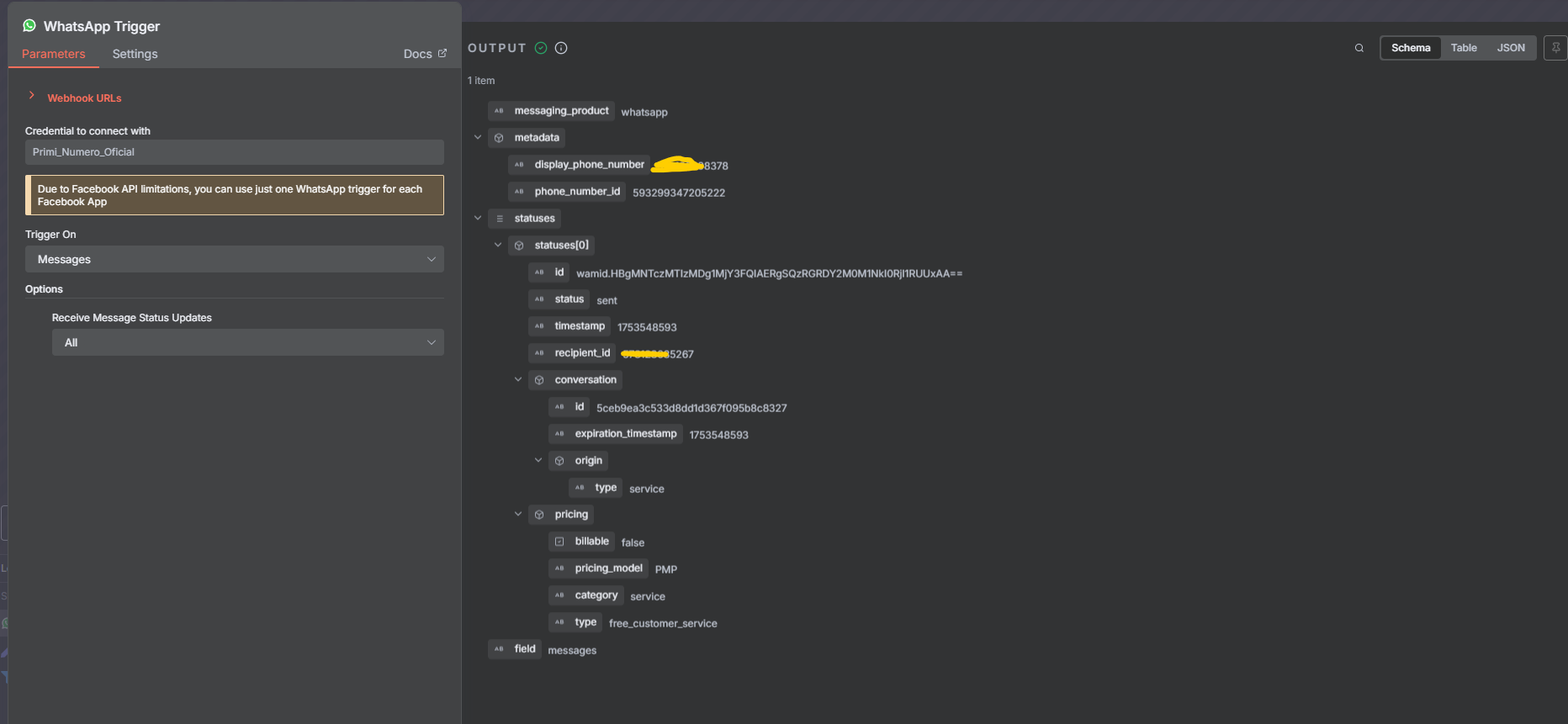

look there is the input in the production flow
and this is the input in the test flow
the difference is that in the test there is a body message and in the production is mising. Why?

Hi there @Eliot , you can see for yourself that the one that gets discarded on the production logs is with the event type Read, you can see that in the status.statuses[0] it says Read
As i have told you in the above, that production hears every event that happens in a message, including when a message get a read from the receiver of the message,
The only reason it’s not showing when you are testing, is because as i said, testing does not hear everything, it only hears the event when you want them to
If you want to trigger the failing on the test, make sure the webhook only receives read event and then send a message, and then execute the workflow, and read the message, that should get you your error
So this is definitely not a bug

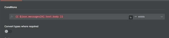

hi there, you can just add an if node right after the whatsapp trigger to check if the data contains the message, if it is then continue the workflow, if it is not, just don’t do anything
this way, it shouldnt cause issue with your simple memory because the execution that will go through the rag agent is the data that has the message
