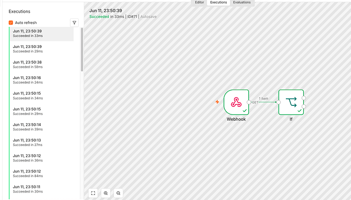

遷移前:
  • 佇列模式運作正常
  • 執行成功完成
  • 沒有 PostgreSQL 逾時錯誤

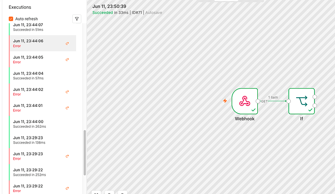

遷移後:
  • Redis 重新連線訊息開始出現
  • 工作程式執行失敗
  • 出現 PostgreSQL 連線逾時錯誤

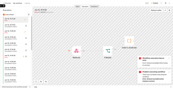

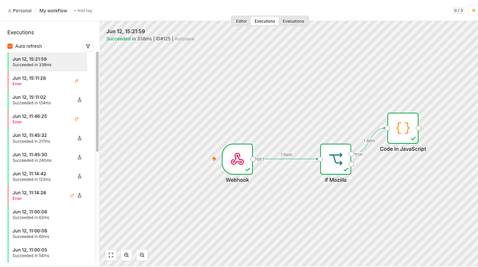

好的,我剛剛再測試了一次,只用了一個 POST
在執行標籤中,這個 POST 顯示為 佇列 然後 失敗
這個 n8n 上沒有其他工作流程,我只是在這裡試著使用佇列模式
這個工作沒有出現在任何工作程序上
它只是在主要 N8n Pod 上失敗
Lost Redis connection. Trying to reconnect in 1s... (0s/10s)
Recovered Redis connection
Enqueued execution 122 (job 166)
Execution 122 (job 166) failed
Error: timeout exceeded when trying to connect
    at /usr/local/lib/node_modules/n8n/node_modules/.pnpm/pg-pool@3.6.2_pg@8.12.0/node_modules/pg-pool/index.js:45:11
    at PostgresDriver.obtainMasterConnection (/usr/local/lib/node_modules/n8n/node_modules/.pnpm/@n8n+typeorm@0.3.20-15_@sentry+node@9.42.1_mysql2@3.15.0_pg@8.12.0_sqlite3@5.1.7/node_modules/src/driver/postgres/PostgresDriver.ts:1181:28)
    at PostgresQueryRunner.query (/usr/local/lib/node_modules/n8n/node_modules/.pnpm/@n8n+typeorm@0.3.20-15_@sentry+node@9.42.1_mysql2@3.15.0_pg@8.12.0_sqlite3@5.1.7/node_modules/src/driver/postgres/PostgresQueryRunner.ts:248:36)
    at SelectQueryBuilder.loadRawResults (/usr/local/lib/node_modules/n8n/node_modules/.pnpm/@n8n+typeorm@0.3.20-15_@sentry+node@9.42.1_mysql2@3.15.0_pg@8.12.0_sqlite3@5.1.7/node_modules/src/query-builder/SelectQueryBuilder.ts:3660:25)
    at SelectQueryBuilder.getRawMany (/usr/local/lib/node_modules/n8n/node_modules/.pnpm/@n8n+typeorm@0.3.20-15_@sentry+node@9.42.1_mysql2@3.15.0_pg@8.12.0_sqlite3@5.1.7/node_modules/src/query-builder/SelectQueryBuilder.ts:1617:29)
    at SelectQueryBuilder.executeEntitiesAndRawResults (/usr/local/lib/node_modules/n8n/node_modules/.pnpm/@n8n+typeorm@0.3.20-15_@sentry+node@9.42.1_mysql2@3.15.0_pg@8.12.0_sqlite3@5.1.7/node_modules/src/query-builder/SelectQueryBuilder.ts:3322:26)
    at SelectQueryBuilder.getRawAndEntities (/usr/local/lib/node_modules/n8n/node_modules/.pnpm/@n8n+typeorm@0.3.20-15_@sentry+node@9.42.1_mysql2@3.15.0_pg@8.12.0_sqlite3@5.1.7/node_modules/src/query-builder/SelectQueryBuilder.ts:1661:29)
    at SelectQueryBuilder.getOne (/usr/local/lib/node_modules/n8n/node_modules/.pnpm/@n8n+typeorm@0.3.20-15_@sentry+node@9.42.1_mysql2@3.15.0_pg@8.12.0_sqlite3@5.1.7/node_modules/src/query-builder/SelectQueryBuilder.ts:1688:25)
    at ExecutionRepository.findSingleExecution (/usr/local/lib/node_modules/n8n/node_modules/.pnpm/@n8n+db@file+packages+@n8n+db_@opentelemetry+api@1.9.0_@opentelemetry+sdk-trace-base@1._ab22bba05a964211b9fe14bf4b841570/node_modules/@n8n/db/src/repositories/execution.repository.ts:315:21)
    at JobProcessor.processJob (/usr/local/lib/node_modules/n8n/src/scaling/job-processor.ts:57:21)
Problem with execution 122: Error: timeout exceeded when trying to connect. Aborting.
Error: timeout exceeded when trying to connect (execution 122)
Error: Error: timeout exceeded when trying to connect
    at Queue.onFailed (/usr/local/lib/node_modules/n8n/node_modules/.pnpm/bull@4.16.4_patch_hash=a4b6d56db16fe5870646929938466d6a5c668435fd1551bed6a93fffb597ba42/node_modules/bull/lib/job.js:523:18)
    at processTicksAndRejections (node:internal/process/task_queues:104:5)

=主節點=
execution 124
Defaulted container "n8n-main" out of: n8n-main, npm-install (init)
Initializing n8n process
n8n ready on ::, port 5678
[license SDK] Skipping renewal on init: license cert is not initialized
Attempting to reinstall missing packages
Failed to execute npm command
Failed to reinstall community package n8n-nodes-minio: Failed to execute npm command
Failed to reinstall community package n8n-nodes-firebird: Failed to execute npm command
Instance registered
Discovered 4 cluster checks
Cluster check warning Detected 2 instances claiming leader role: 0490eef8-9207-4ef7-a379-4699f18e001c, 2586c901-fd3c-4c06-a190-a4197e69f325
Currently active workflows:
- My workflow (ID: QFQvCXo8mBhadrAM)
Version: 2.25.7
Building workflow dependency index...
Start Active Workflows:
Finished building workflow dependency index. Processed 0 draft workflows, 0 published workflows.
Activated workflow "My workflow" (ID: QFQvCXo8mBhadrAM)
Editor is now accessible via:
URL-HERE
Enqueued execution 123 (job 167)
Execution 123 (job 167) finished
Enqueued execution 124 (job 168)
User attempted to access a workflow without permissions
Execution 124 (job 168) failed
Problem with execution 124: Error: timeout exceeded when trying to connect. Aborting.
Error: timeout exceeded when trying to connect (execution 124)
125 OK
所以這是某種隨機的
==Worker==
n8n worker is now ready
Version: 2.25.7
Concurrency: 2
Registered runner "JS Task Runner" (oqClB5JFV1-IPGaVNCRFu)
Worker started execution 123 (job 167)
Worker finished execution 123 (job 167)
Worker started execution 125 (job 169)
Worker finished execution 125 (job 169)
=Main=
Enqueued execution 125 (job 169)
Execution 125 (job 169) finished
