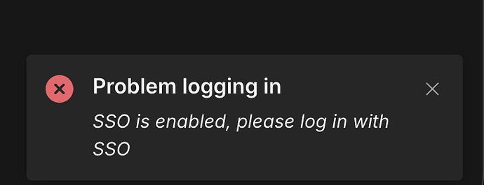

I had same situation in an self hosted n8n; when SSO is enabled, login by user and password was failing with message error:

That scares me a lot because the impact wasn’t clear (at least for me). Still made the change in a test env and surprise it worked. SSO was no longer available at login page and was able to use user and password to login. Of course, users that only use SSO was having an error.
