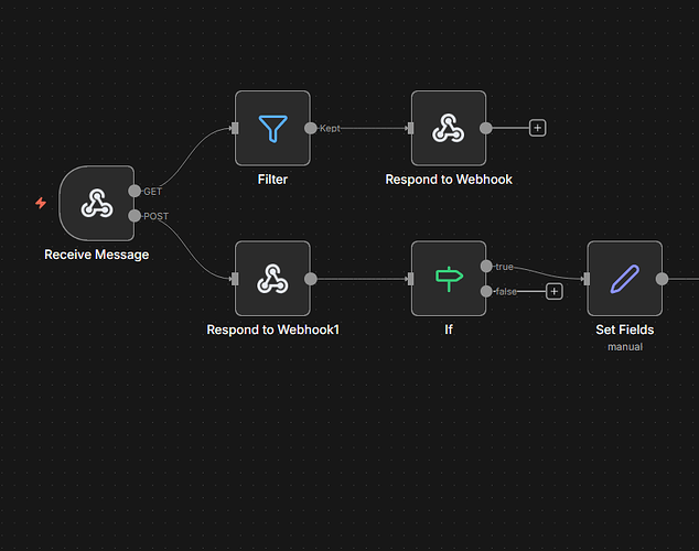

I found a fairly easy workaround to the problem!
I simply put a ‘response to webhook’ node after the ‘webhook’ node, so it gets back an instant 200 OK response. I have tried put it after the ‘HTTP Request’ node aswell, but it did not worked that way.
However this way works perfectly!

Step 1: Add “Respond to Webhook” node immediately after Webhook
  • Respond With: No Data
  • Response Code: 200
  • :warning: Set Webhook node → Response Mode: Using 'Respond to Webhook' Node

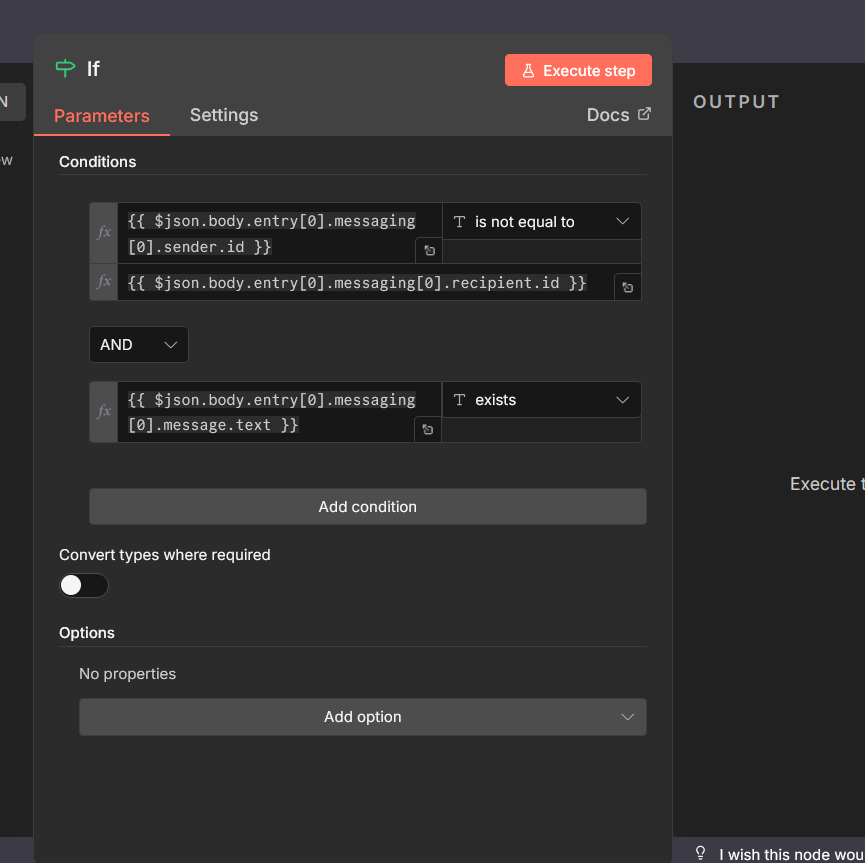

Step 2: Add IF node with these conditions (AND):
Condition Expression Operator
Not an echo {{ $json.body.entry[0].messaging[0].sender.id }} is not equal to {{ $json.body.entry[0].messaging[0].recipient.id }}
Message exists {{ $json.body.entry[0].messaging[0].message }} exists
Text exists {{ $json.body.entry[0].messaging[0].message.text }} exists
Why This Works
  • sender.id ≠ recipient.id → Filters out echo messages (works for multiple pages!)
  • message exists → Filters out read receipts, delivery receipts
  • message.text exists → Ensures actual text message is present
:wrench: Final Workflow Structure
Webhook
Respond to Webhook (200 OK) ← Immediate!
IF Node (3 conditions above)
True → Continue processing
False → Stop
