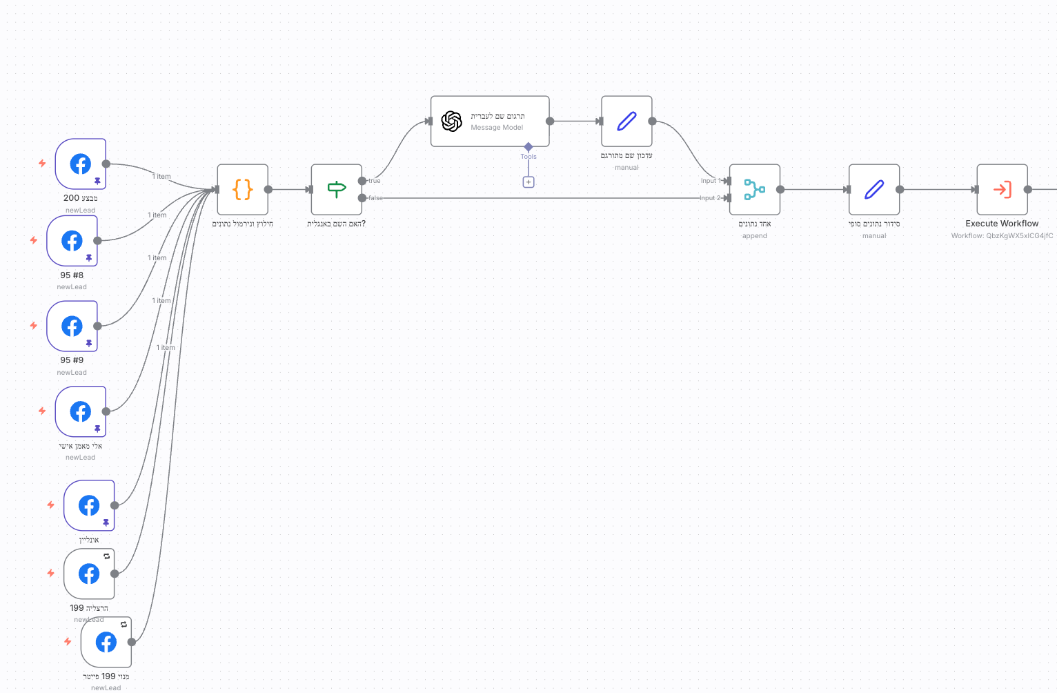

Hi Mate, I was going crazy trying to figure this out. Unfortunately, I couldn’t find anyone to help me, and it took me two weeks. Write to me here: rulesecom@gmail.com.
I’ll send you my master workflow!
@**Adeative_Media
Alright, sent you an email.. thanks!
