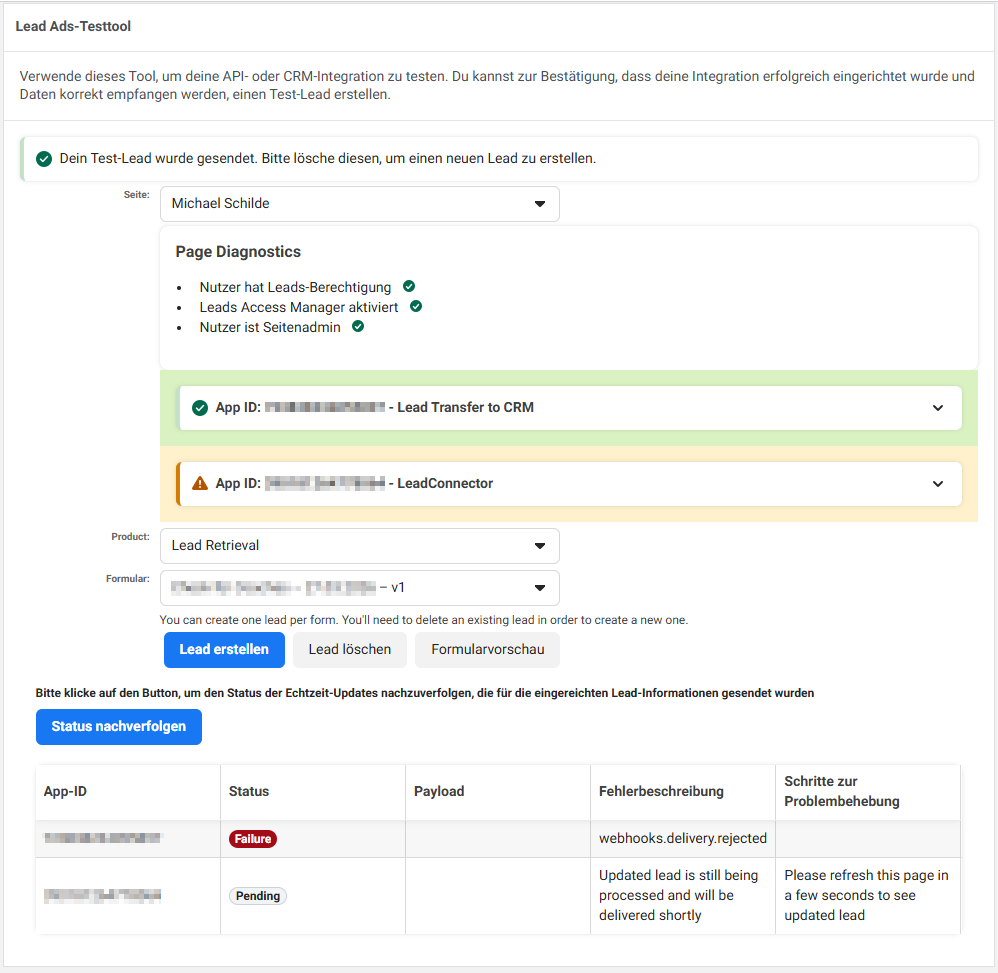

When using the Lead Ads test tool to send a test lead, an execution pops up in n8n but runs into the error below.
Does anyone have an idea what might still be missing? Another permission?
The app has advanced permissions for public_profile and standard permissions for the rest; the Lead Ads Test tool shows everything “green” for the app.

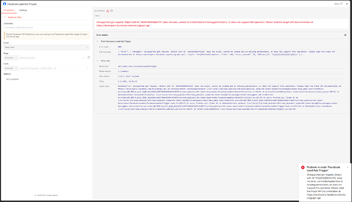

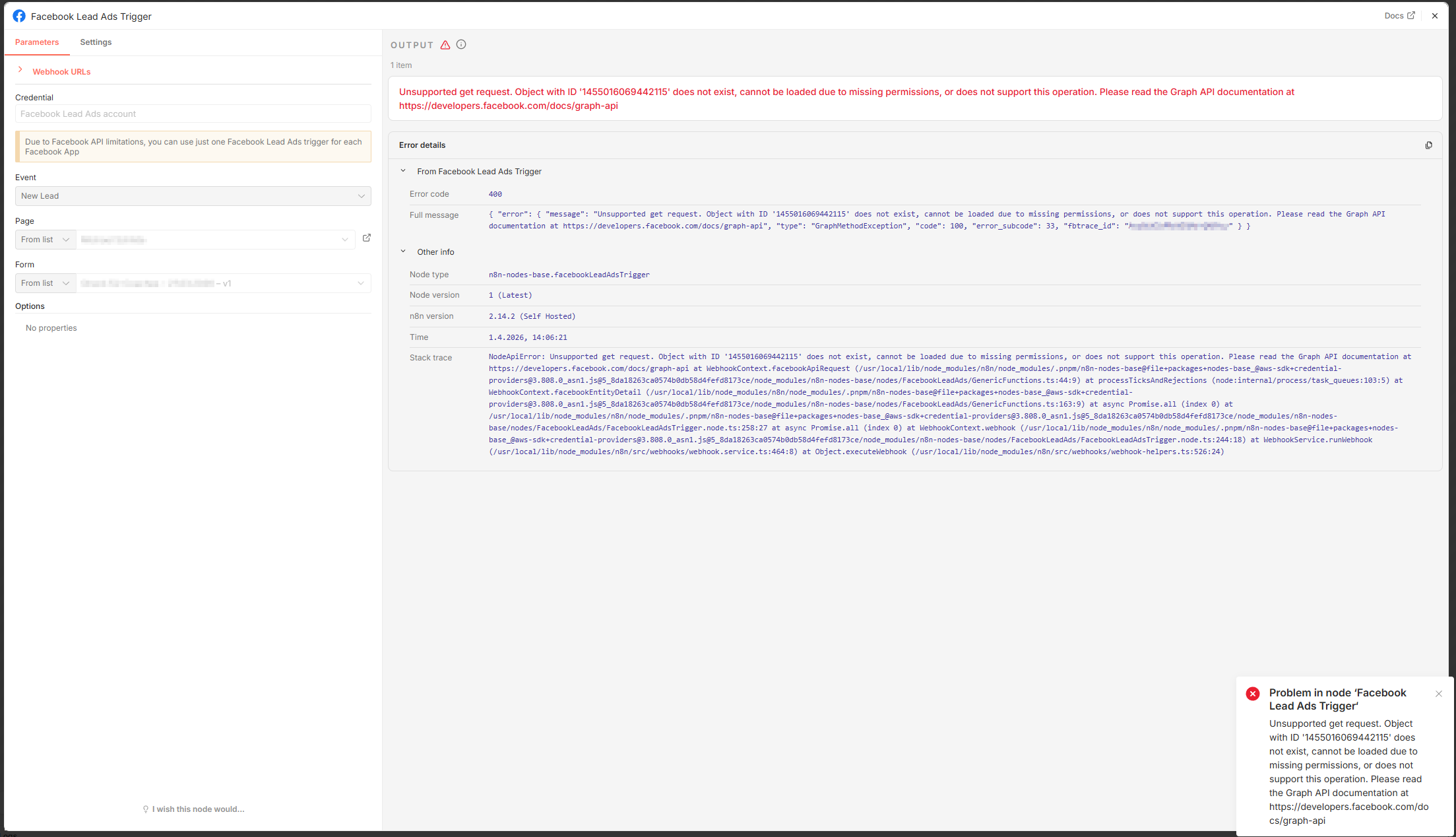

Problem in node ‘Facebook Lead Ads Trigger‘
Unsupported get request. Object with ID ‘1455016069442115’ does not exist, cannot be loaded due to missing permissions, or does not support this operation. Please read the Graph API documentation at https://developers.facebook.com/docs/graph-api

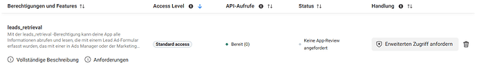

That object ID is the lead itself, so n8n gets the webhook notification fine but then fails when it tries to fetch the actual lead data. Make sure your app has the leads_retrieval permission approved in the Meta app dashboard, not just pages_manage_ads
Hi @achamm. Thanks for the hint.

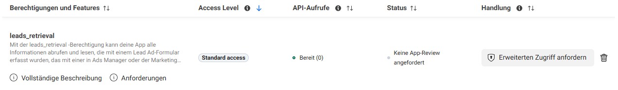

The app has the leads_retrieval permission with a standard access level saying “ready”. The same is true for all other permissions, except for public_profile, which has extended access already. Do I need to apply for extended access for this to work?

Since n8n is already receiving the webhook, the issue seems to happen in the second step, when it tries to fetch the actual lead data from Meta. Because you recently created the app and changed permissions, I’d reconnect the Facebook Lead Ads credentials in n8n, make sure the app is in Live mode, then republish the workflow and test again.

You’re correct - before mid-2024, leads_retrieval only needed Standard Access (or worked in Development mode for test apps). Meta changed this: as of their 2024 enforcement wave, leads_retrieval now requires Extended Access for production use. In Development mode you can still test with app admins/testers, but any real lead from a live ad will hit the permission wall. To get Extended Access, go to App Review > Permissions and Features, find leads_retrieval, and submit a review request with a screencast showing your use case. Meta usually approves it within a few days for legitimate lead gen workflows.
